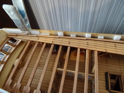

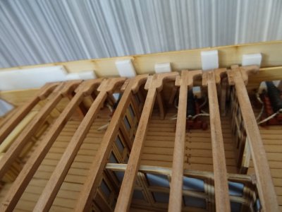

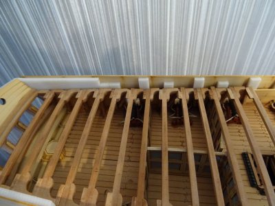

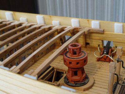

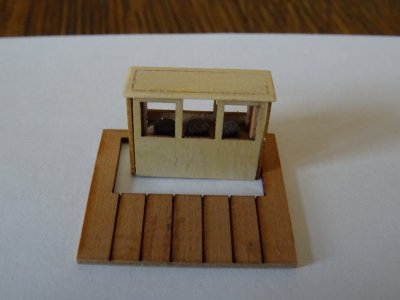

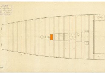

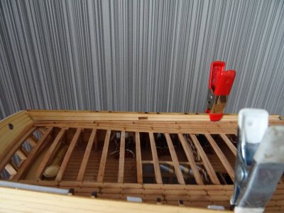

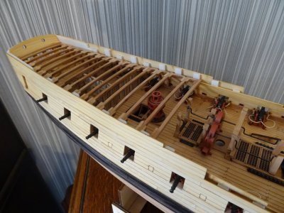

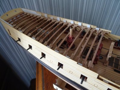

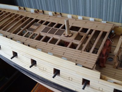

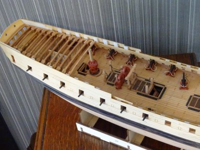

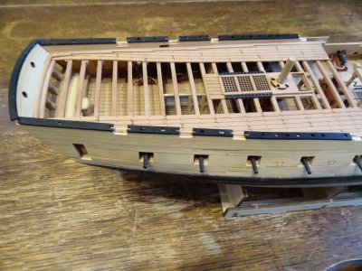

so I decided to assemble the binnacle to give me guide for the supports spacing but something is badly amiss
Hi Roger
Hope the following is a bit of help. The binnacle sat on top of the deck planks, often without additional support such as beams. As it sat on the QD there would not be any carlings or ledges. It was held down and in place with ropes tied to eyes anchored in the deck planking and removed when not at sea. If you look at the inboard profile of similar 24 gun ships of that era it would appear the binnacle actually lays between, or maybe touched above one beam. Interestingly, by an order from the Admiralty, the number of binnacles on a ship was reduced from three to two. Lavery comments that it is not clear where the extra ones were placed, possibly below as spares.

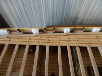

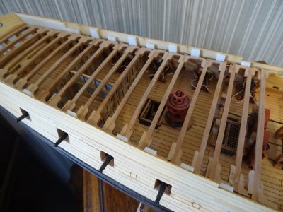

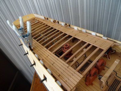

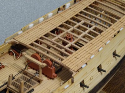

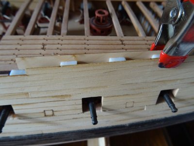

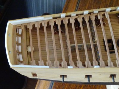

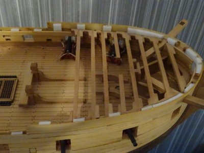

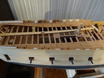

side walls planking has to be fitted before the decks so lots of acetone and time and it amazingly came of with no damage
Too late now as you went to all the work to remove the planking but for the 18th century I think if the waterway is fitted first it does not matter if the spirketting and quick work go on first or the margin plank and deck planking.

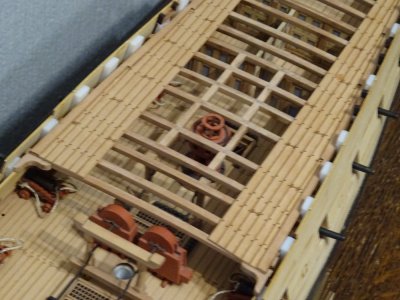

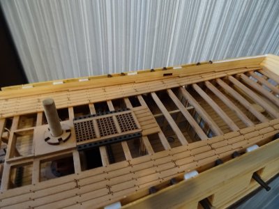

Do the plans call for the battens on the gratings to run athwartships instead of the normal fore and aft direction? The kit looks to be really good, and accurate so this seemed odd that they would have the gratings 90 degrees in the wrong direction.
Thanks
Hi Allan
The kit comes with no instructions or plans in the box the online plans (downloaded from modelship dockyard site) are just 3D rendered drawings no real instructions but very good customer support
The gratings are laser cut to match the laser cut holes in the decking so they can only be fitted one way so i assume this is just a slight error
There was a similar discussion on the gratings of the Granado in Uwe's thread, where the battens fore passageway has them running athwartships instead of the normal fore and aft direction. This is shown by Goodwin as being correct.
I think I have some reasoning on this, indicating both the Granado and the above case: MOST gratings in size are longer fore-to-aft than they are athwartships. This seems fairly common. Unlike scale model gratings, the upper battens are thinner strips (1x2" on the Granado), so are fairly weak and flexible, while those crossing and supporting the upper battens are double that thickness, or so. The strongest possible construction will be to have the lower/stronger battens across the shorter length, while the upper/weaker battens go the longer length of the hatch and are supported by the lower. This means that on a "normal" grating which is longer fore-to-aft than it is athwartships the upper battens will go the "normal" direction, fore to aft.
However, in the above case there are three smaller gratings, each wider than long. And in the case of the fore grating on the Granado, it is also wider than long. So my hypotheses is that the lower/thicker members should always go across the shorter length of the grating, while the upper battens will run the long direction, regardless of the direction the hatchway.
This makes sense to me, at least, meaning all examples I've seen are correct, and all's right with the world. ;-)
As they are precut there is no choice, but Signet makes a valid point.

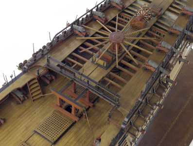

It does make some sense to me as well, but apparently not to many of the old ship model builders or shipbuilders. :) I found one exception so far. The second photo shows the battens running athwartships on the Minerva (38) 1780 model at Preble Hall. But, this model was renovated/repaired in 2015 so may not be as originally built.
Minerva Model at Preble Hall
Victory gratings today. I HOPE they replicated the way things were done in 1803. Five or six long ledges athwartships, 11 short battens fore and aft
