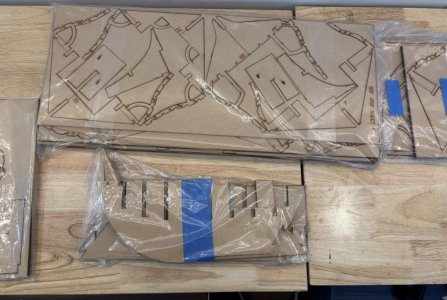

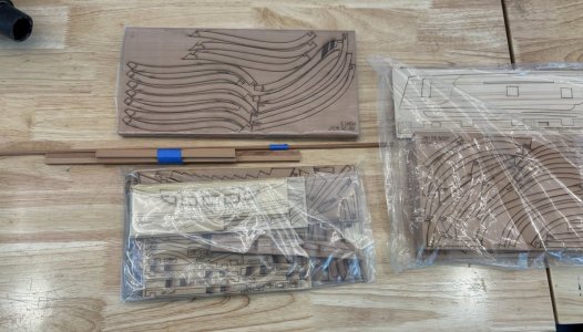

Hi All,
Im going to start a build log of my latest model kit of HMS Portland 1770, which was a 4th rate of 50guns.
This kit is currently not available yet for general sale and I was asked by the designer to build one of the first prototypes, this will be a Hybrid POF/POB kit in the classic 1:48 scale, size will be very large in this scale without any masts or rigging.

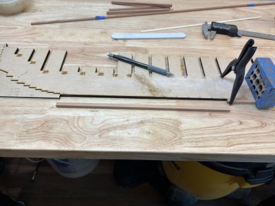

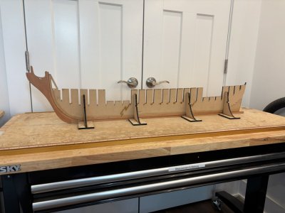

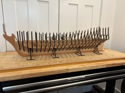

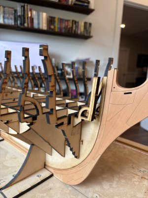

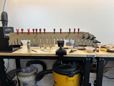

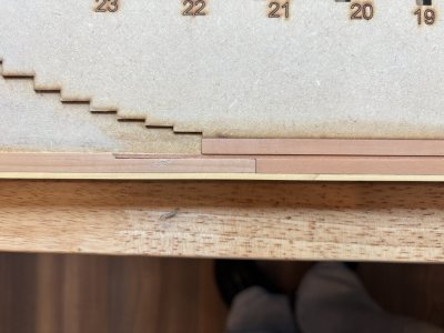

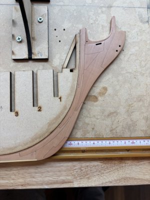

Final progress from this weekends work, the sanding of the Knee to its correct dimensions and then its installation onto the former along with the keel and false keel pieces.
Now she is on the build board ready to start testing the fitment of the bulkheads.
IMG_7535.thumb.jpeg.1d0fff180e63c7687aa3891316cc50cd.jpegIMG_7537.thumb.jpeg.e81a3d052b127f4d4309b487d08b2bbc.jpegIMG_7538.thumb.jpeg.9e184df7aa70c58d2ac27216b82bfaf3.jpeg

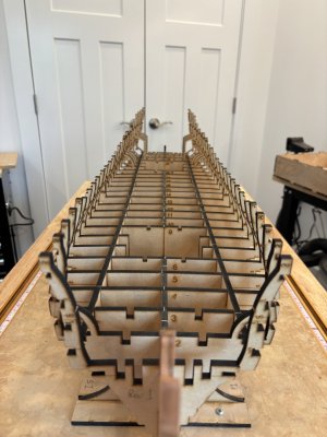

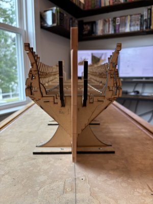

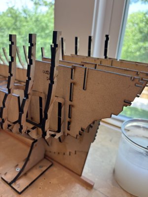

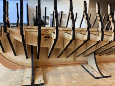

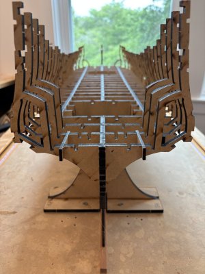

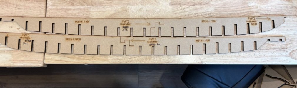

All of the bulkheads were removed from their sheets and dropped into position on the former, no adjustments were needed to any of them to make them fit!
No glue has been used so far and you can see the longitudinal stiffeners being installed - fore sections first and then the aft ones, after these clipped into place with a little persuasion the entire structure has really begun to get more solid.
More bulkhead and stiffner work to come before glue goes anywhere near it.

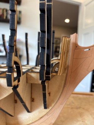

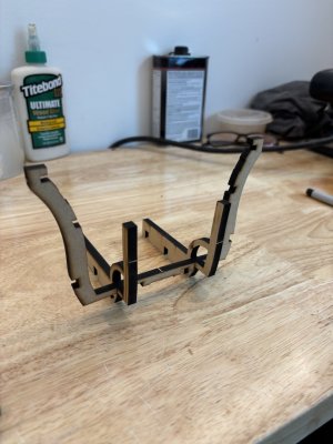

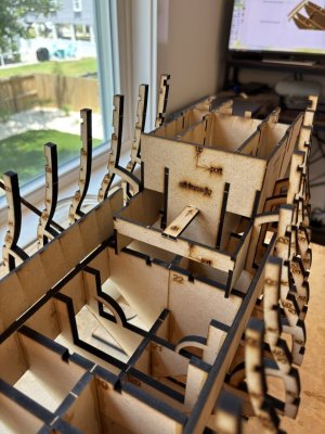

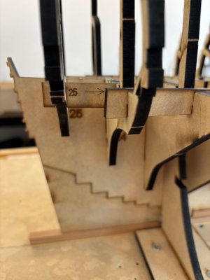

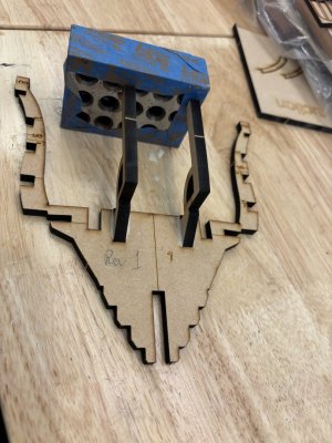

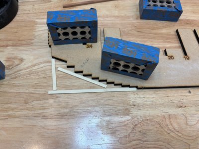

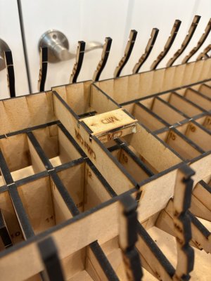

So the foremost bulkhead #1 requires that these two upright bow supports be glued into place before it is installed, making sure to make them perpendicular.
Also the stiffners between aft bulkheads 24 & 25 need to be installed to tighten that section up.
IMG_7546.thumb.jpeg.08ecab064010142a5d182af0a4bab267.jpegIMG_7550.thumb.jpeg.24d5b37eb113424687f6c77aa006a5b9.jpegIMG_7551.thumb.jpeg.689456aa2e08f4485fec1e8ab52dfdd5.jpegIMG_7547.thumb.jpeg.0d0424c6ea55aef9d2bf849fffaa061e.jpegIMG_7548.thumb.jpeg.25a9f493d06e48a20ab7ca66f64589bd.jpeg

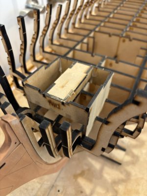

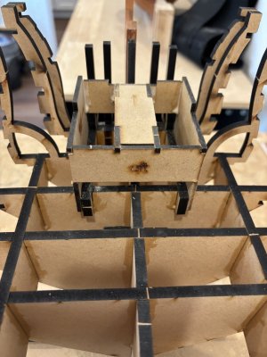

Last bulkhead to be installed is for just forward of #1, it is for the beakhead support, it also has two verticals for the bow and it locks bulkheads 1/2/3 together for more stiffening.
There should be a 1/16-1/32” gap between it and bulkhead #1.
With all these parts now installed, the entire structure is very very stiff with almost zero movement anywhere and is now ready to start having glue applied to it, kudos to JJ for his design and laser cutting to make this as solid as it is.
IMG_7549.thumb.jpeg.c427560f49c9c2af4cb990b5152f5d71.jpegIMG_7552.thumb.jpeg.29c61bc24e682ce7effe15344ccc1197.jpeg

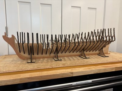

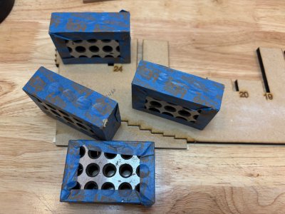

All of the bulkheads and stiffners have been glued to the former and themselves, this thing is now rock solid and a very sturdy platform for everything thats to come.
I have begun installing all of the jigs that will support the upper parts until the model has been planked on the outside, these jigs are NOT to be glued to the model as they will be removed later for all the internal work, here you can see the forward one.
IMG_7554.thumb.jpeg.d81ad5082c4884a9f12588f0e0cffed5.jpegIMG_7553.thumb.jpeg.8a94c32bd7a42e6f9b7d53bfc5d14b77.jpeg
