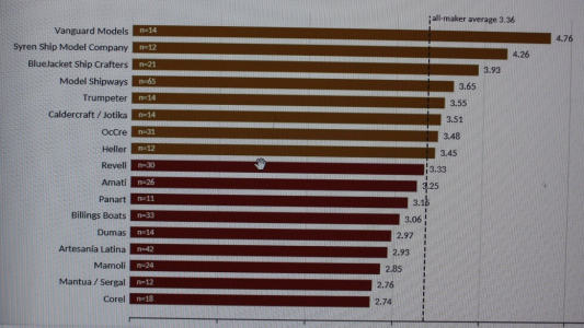

I looked at the SIS poll again. Speedy is from Vanguard Models. Sophie is from Mamoli. If the polling done by SeaWatch Publishing on kit quality is a guide, it is a no brainer which kit to go with.
No Sophie from Mamoli Allen, just their, frankly laughable, Surprise.

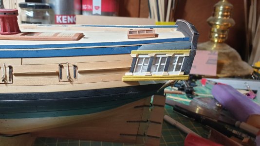

A good choice is to kit bash HMS badger, unless you want to scratch build. The high convex deck to the quarterdeck can be levelled off to leave possible room for a small increase in bulwark height and low railings. The domed stern isn't suitable for a Sophie but this can be completely reworkd with the levelling of the quarterdeck to something with more of a gallery like Geoff Hunt's book cover painting. Also there's the Brig Phoenix by Master Korabel which is a design closer to Sophie as most people tend to imagine it. It's small at 1:72 and relies on glue on veneer like Vanguard. You woud need to substitute that with a planked version. Phoenix is also a gunport short, 6 a side, so needs bashing. Whichever way you go you'll have to do some architectural work. Personally I find this sort of approach very rewarding. (I used HMS Fly as a base for the Hornet and added a scratch gallery)377863671_334328302452866_5943496621592444506_n.jpg
