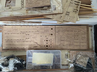

THE GOOD
The dimensions of the hull and the positioning of the gunports, hatches and masts correspond exactly to plans by KH Marquardt once they are scaled to 1:46. This is the true scale of this kit.

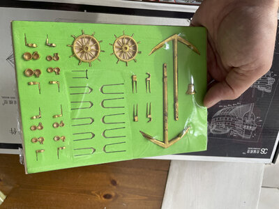

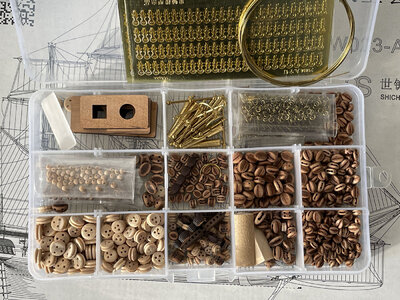

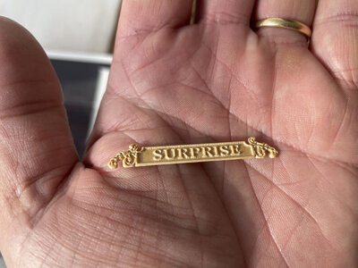

To my untrained eye the quality of the supplied wood and the accuracy of the laser cut part seems very high. The boxwood carvings for the figurehead, stern carvings and other ornaments are lovely. The brass guns, anchors, bells and copper plating stickers, wooden blocks and in general all the supplied parts are of a high quality.
A huge plus is that the planking of the hull is of a high quality basswood and is ready splined, so even for a beginner one can achieve a very nice result. There is also supplied strips if one wishes to make a second planking.

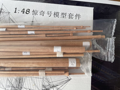

Masts and spars are ready shaped.

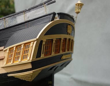

The kit seems to be a cross between the plans of the original Unité by John Marshall, and the replica HMS Surprise (Rose). The figurehead and stern carvings are exactly from the replica ship.

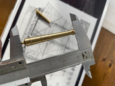

The armament consists of long guns in two sizes, 55mm and 48mm. I believe at 1:46 this would correspond to a 9-pounder and 6-pounder (roughly 8ft & 7ft)?

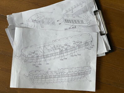

The instructions are a joke. 16 pages of photocopied line drawings that fall from their binder at once. The instructions are more like a map of where you should get to, but not HOW to get there.
The order they suggest is very misleading. For example, they suggest you install all the armament and deck fixtures before you start planking the lower hull.

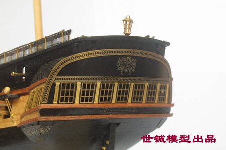

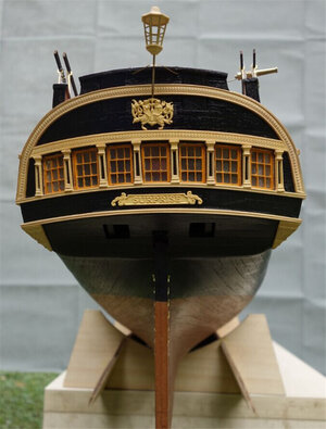

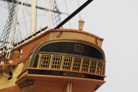

I have long wanted to see the construction of this model.They actually scolded the model at a scale of 75. 48 scale is a very good model.We will wait for the construction review.We will wait for the construction review.As they say, feel the difference.
1-48.jpgHe4ae4be85f4d4c2bb55ea0738a33347cs.jpgT2iRhLXbFaXXXXXXXX_!!58805468 (2).jpgT2zks_XiJXXXXXXXXX_!!58805468.jpg
