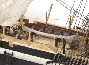

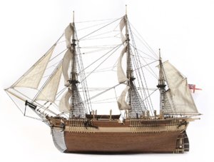

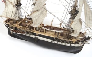

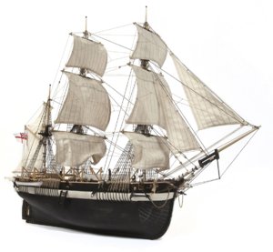

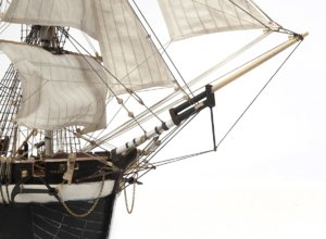

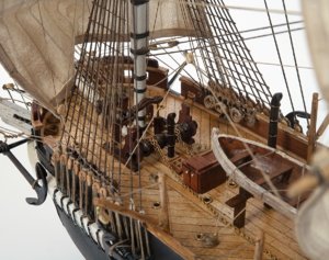

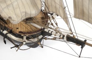

The finished model from Occre:
The Model KIT from Occre:
Specifications:
  • Length: 676mm.
  • Height: 504mm.
  • Width: 195mm.
  • Scale: 1:75
  • Occre Ref: 12004
very often the model scale is mentioned with 1:65, which is a wrong scale information.
The correct scale of this model is 1:75
The kit is available directly from Occre for a very reasonable price of 119,95 Euro
The same model "out of the box" without colors or other paintings

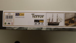

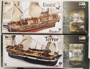

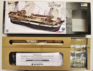

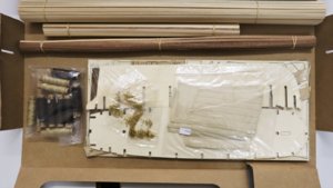

The box and general information about the content:

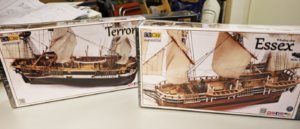

I received the models of the HMS Terror and also of the Whaling ship Essex directly from Occre, every single kit secured packed in an outer box for safe transport

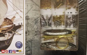

Both boxes have a cutaway area to see the box / tray with the small fittings - nice idea to see the quality of these important parts
So have a closer look to the HMS Terror
The correct scale is in the meantime also mentioned on the side of the box

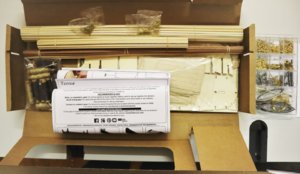

Unboxing:

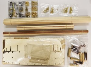

we can see on the right the fitting tray, on the top the bundles with the timber strips, on the left the rigging material, the sails, bulkheads and the manuals.
Everything well packed, separated and organized - With this organization inside the box, the possibility of transport damages is limited to a minimum - well done Occre!
the small fittings safely separated in a special box

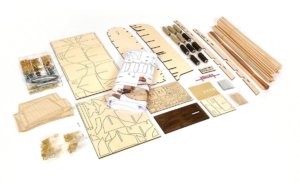

and here a complete overview of all construction parts (without manuals)
and a similar photo from Occre

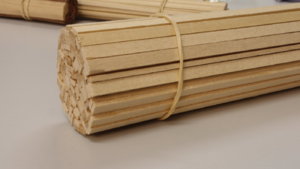

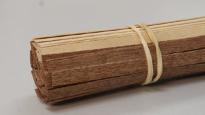

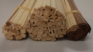

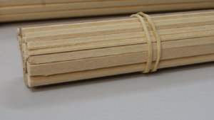

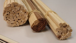

Kit Content - TIMBER - Strips for planking etc
The models hull has a double planking
For the first planking level the kit offers Ramin strips of 2mm * 5mm * 600mmIMG_4922.JPG
The second planking is Sapelli with dimension 0,6mm * 5mm * 600mm
also the other timber strips and spar / dowels have very good quality and are straight
The quality of the timber (all strips) is excellent with good, clean edges and no splintered wood, no wrong dimensions or defaults like knotholes etc.
Also the strips have overall the same color and have a good a relatively small grain - Very Good

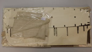

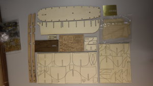

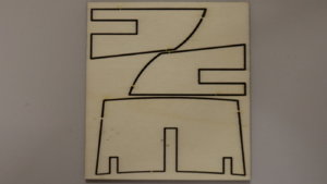

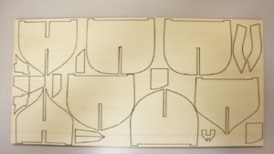

Kit Content - TIMBER - Other wooden parts like Bulkheads etc.
The rest of the timber is packed and sealed separately in a plastic blister to avoid moisture
all parts shown in an overview

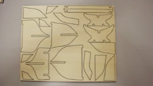

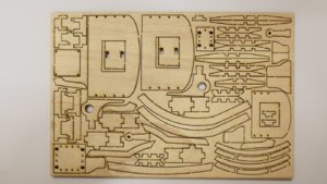

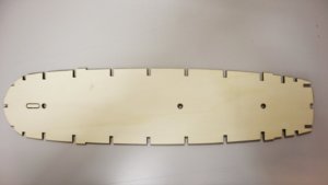

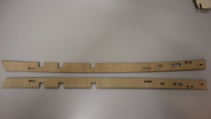

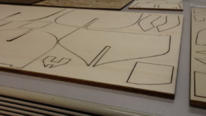

the bulkheads and some other parts - clean laser cut Plywood
No warp - good quality plywood is used by Occre

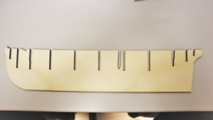

The false keel and the false deck are also made out of plywood - the same high quality - already ready to use, so no removing from a sheet necessary

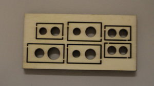

some other sheets - here plywood of a higher grade used for smaller components, such as the mast tops etc.

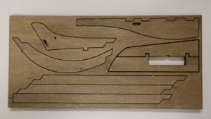

a walnut-stained piece of plywood, that contains the parts for the keel and rudder
final timber parts for the bulwarks, made from thinner plywood
Overall good quality timber - Well done Occre

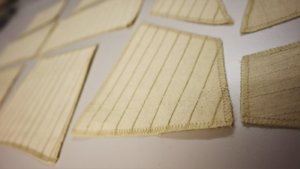

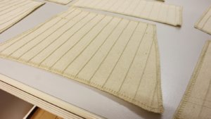

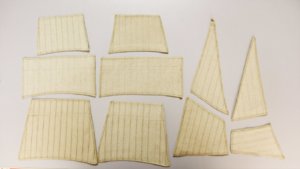

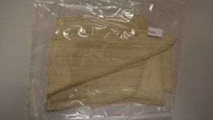

Kit Content - SAILS
the sails are also packed in a separate bag to avoid moisture and protect them from humidity
The overview showing all of the ten sewn sails - already slightly "weathered"

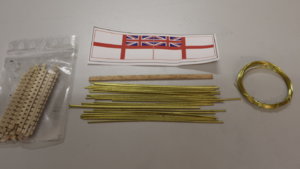

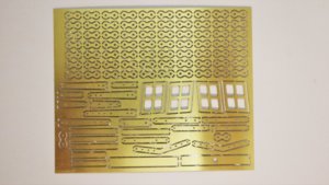

Kit Content - Brass photo etched

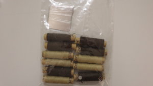

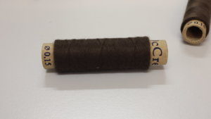

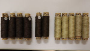

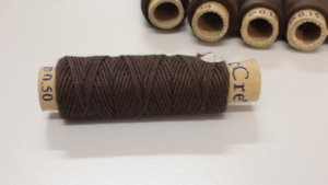

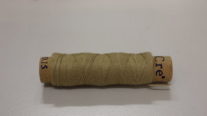

Kit Content - Rigging cord
The quality of the cord is good - and I guess it is enough material to rig the ship completely

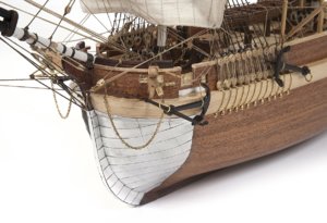

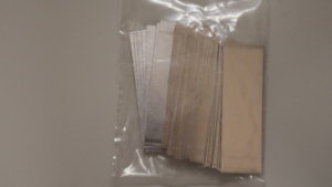

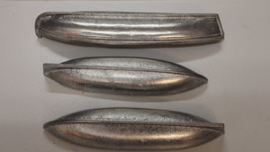

Kit Content - Sheet plating for the bow
HMS Terror was plated at the bow with iron to protect the ships hull against pack ice. This kit provides zinc plates which can be formed around the bow to represent the large plate sheathing

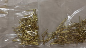

and additional there are some small bags with some brass nails (also good quality)

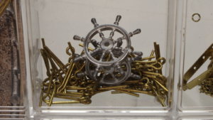

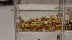

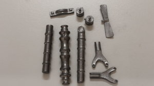

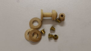

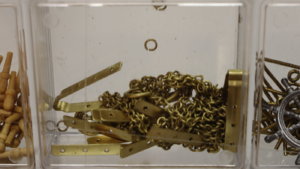

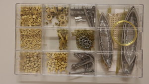

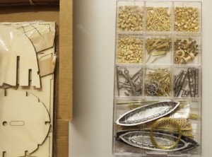

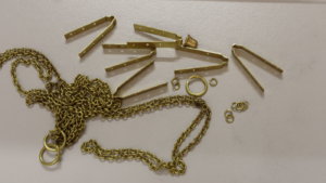

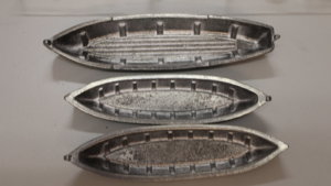

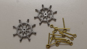

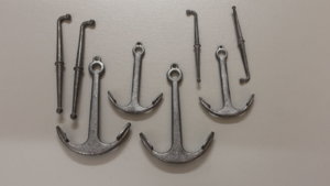

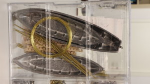

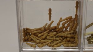

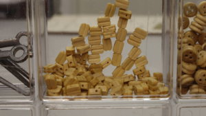

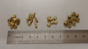

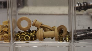

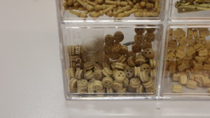

Kit Content - Fittings etc.

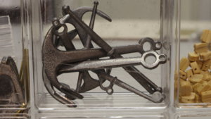

The fittings are separately boxed - clever idea, so you can open and close when ever you need one of these fittings
The anchors
all over good quality fittings - for this price level of kit - very good Occre

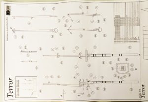

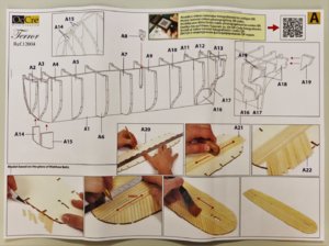

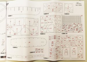

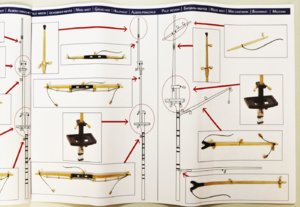

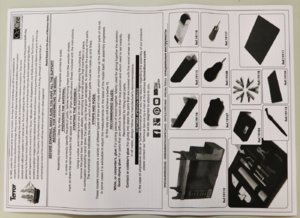

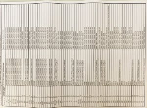

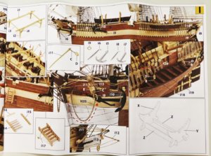

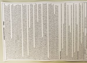

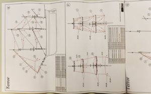

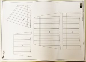

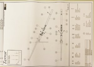

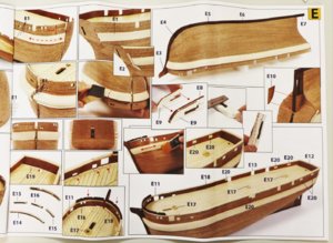

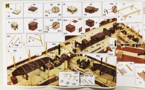

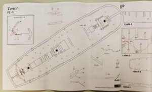

Kit Content - Manuals and Drawings
I will show the manuals given in the kit in Thumbnail size, for a better overview

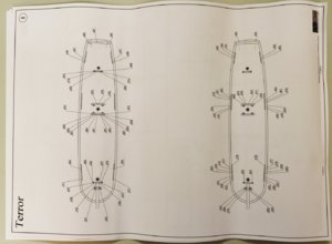

Two sets of paper manuals are encluded in the kit, printed on DIN A3 paper.
The black and white sheets contain the vessel history, parts inventory, deck layout for parts placement, and some masts and yard drawings.

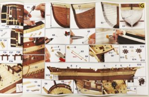

The color package shows the construction of model as a photographic experience, with simple and clear annotation.
Some Illustrations for masting and rigging are also available, plus the parts overview that you will need for marking the various laser-cut parts
