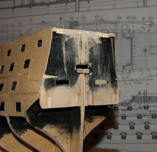

As you can see from the title, it’s HMS Victory. I created the framework of the model using plans from a Mantua kit. I didn’t buy the kit itself. I printed the plans in A0 format and built the frame (the skeleton) based on them. That was the end of my work with the Mantua kit. All further work was based on John McKay’s anatomy of the ship. In this journal, I want to take you through the whole process, from the kit plans to the anatomical upgrade.
I would also like to share my experiments: Working with blueprints. Aging and painting wood. Aging copper. Making and painting ropes and rigging. 3D modeling and integrating 3D printing into wooden shipbuilding. And much more. It will be fun, and I hope it will be informative for you. I’m sure I will learn a lot from you as well. Thanks in advance for that!

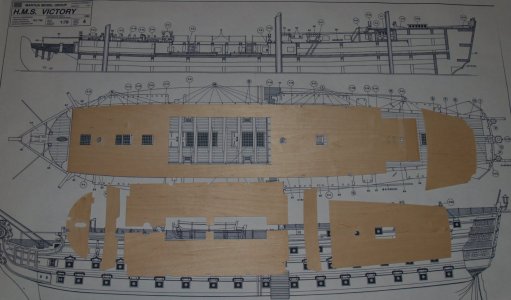

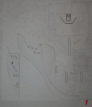

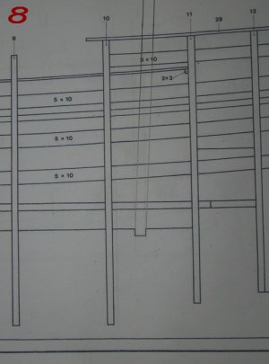

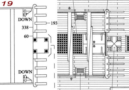

And of course, I'll start with the blueprints. As I mentioned above, I used the plans from the Mantua kit as the basis for the frame. However, I want to note that if you're planning to build this model, make sure to work with better-quality blueprints than those provided in the kit. Don’t repeat my mistakes. My excuse is that I started building in 2009, when I was practically a beginner, and at that time, these were the only complete plans I could find. Nowadays, I would use more accurate frame plans, but it is what it is.
This post is more for those who bought the Mantua kit, and I can point out the problems, errors, and inaccuracies in the blueprints for you. Details are shown in the images below.

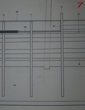

In Figure 1, part 25, it's better to cut off the knee of the head, creating a recess to install it later. It will get in the way when you're planking, and it certainly shouldn’t be made from plywood. And for part 1, you’ll need to create space for the bowsprit, as this wasn’t accounted for in the plans, and you’ll end up cutting into the hull later.

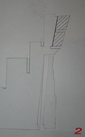

In Figure 2, you can see how the sternpost (the piece to which the rudder is attached) should look, as well as the rudder itself.

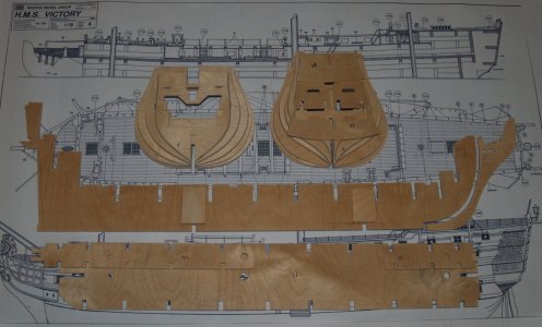

In Figure 3, you can see the part that will become the hull side—it has been reduced in thickness. This applies to the 8th and 9th frames.

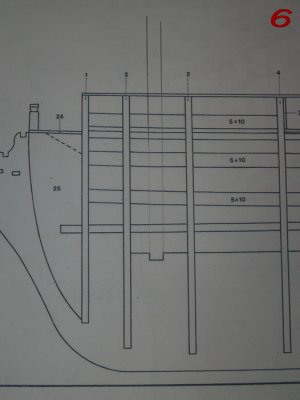

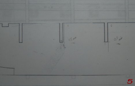

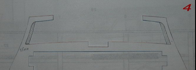

The 5th, 6th, and 7th frames will be modified as shown in Figure 4.

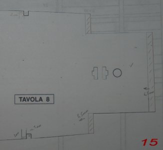

Now, about the discrepancies. In Figure 5, it shows how much you need to shift the cutout for the 4th and 5th frames—by 1.5 mm and 0.7 mm towards the rear.
As is known, a ship's masts are not like houses; they are not always at a 90-degree angle to the horizon (from the side). On the Victory, only the forward foremast is vertical, as indicated in Figure 6...
The main mast has a tilt of 2 degrees, as shown in Figure 7.
The mizzen mast is tilted even more—3 degrees towards the rear, as shown in Figure 8.
So, it turns out that there are no problems at the front; all the holes are in place and everything aligns correctly (see Figure 9).

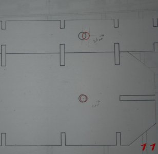

However, moving on, it gets more complicated. In part #15, the hole has shifted by 1 mm, while in part #16, it has shifted by a full 3 mm (see Figure 10).
Similarly, at the rear of these parts, the holes have shifted by 1 mm and 3.5 mm, respectively (see Figure 11).

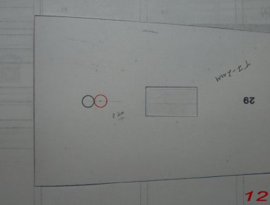

Even higher (in part 29), there is an even greater deviation—by a whole mast body, 8 mm (see Figure 12).
But the most interesting thing happened with part 28. Here, all the holes align correctly, taking the tilt into account! (see Figures 13 and 14)...
However, there is a complete misalignment at the rear. It extends by 5.5 mm and 6.5 mm into the 10th and 11th frames. Therefore, the areas marked with a pencil need to be removed (see Figure 15). The slots for the 8th and 9th frames are also misaligned, but even without that, they need to be cut only 2 mm deeper and 5 mm forward from the incorrect position (see Figures 14 and 15).

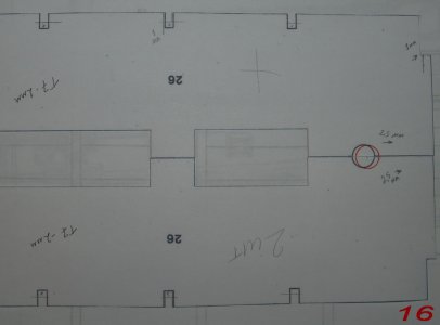

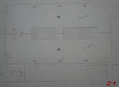

The same problem exists with the lower deck (see Figure 16). The hole is off by 2.5 mm towards the rear, and the slots need to be cut only 5 mm deeper (under the cut for the frame, see Figure 4).

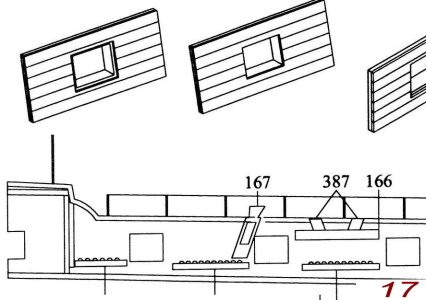

Additionally, the blueprints do not include parts #167 and #387 (from the JoTiKa plans), which are actually very important! Furthermore, the ports are not indicated as being different. In Figure 17, you can see that the left port is designed for a door that fits into the groove, while the right one does not have this door, and the groove (the frame around the opening) is unnecessary.

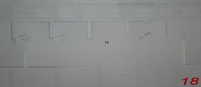

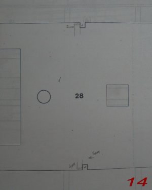

I would also like to return to the hull, specifically to part #14. In advance, I prepared grooves for the base on which the model will stand (see Figure 18).

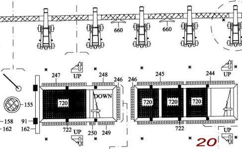

Additionally, the Mantua blueprints do not include parts #660, #162, and #244-247, as indicated in Figure 20 of the JoTiKa plans. Furthermore, the left hatch is longer. I have corrected this, as shown in Figure 21. As for the simplification that Mantua made by removing the ladder to the lower deck and replacing it with doors, I will not be doing that. Both ladders will remain! Consequently, part #16 will be reduced in size. From the 4th to the 8th frames, there will be an interruption in part #16, as indicated in Figure 21.

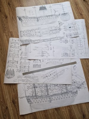

I will only add four sheets of blueprints at a 1:1 scale, each sized A0. This scale is tailored to the dimensions of my specific model—i.e., the size that resulted from the initial construction of the skeleton hull based on the Mantua blueprints!
These blueprints (four sheets) were created from scans of the anatomy book (which I purchased) by combining them in Photoshop, calibrating all the plans to a common standard. I understand that this is complicated to explain and can be difficult to grasp, but the important thing is that it all worked for me! The proportions and dimensions all matched, except for a small section that I will mention in the review. For reference, I am sharing these blueprints here. If I were doing this now, I would create not only these four sheets but also the frames for building the skeleton hull. However, since I already have the hull, I made these four sheets, which illustrate all the other parts I need, such as useful items, rigging, and, most importantly, the proportions of where everything should be located. This is necessary because the simplified Mantua blueprints are lacking in this regard.
I hope this has been useful to you, and if there’s anything to add, feel free to write here. I will try to upload the full-size photos (7000 x 5000 pixels) here.

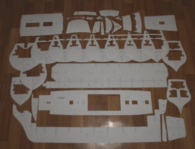

After that, a long task lay ahead—cutting out each part. I started with the 5.5 mm plywood...

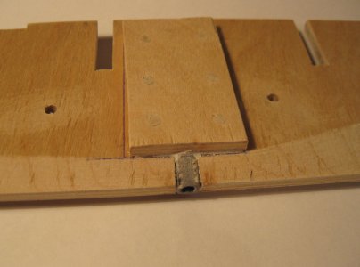

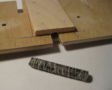

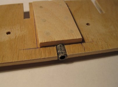

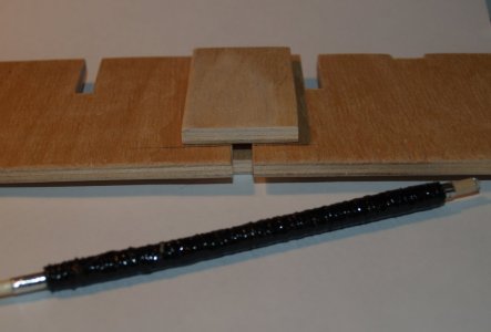

For the future mounting of the model to the stand, I cut two slots, each 6 mm wide. I reinforced this area on both sides with plywood plates. Inside, I placed a cylinder filled with epoxy-soaked threads. Later, a bolt from the stand will be screwed into this cylinder.

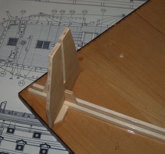

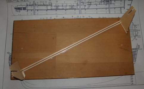

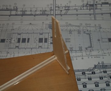

Once all the parts were ready, I created a simple slipway. Plywood tends to warp with humidity changes. And for precise assembly, we need the entire structure to be rigid, with all parts positioned at exactly 90 degrees.

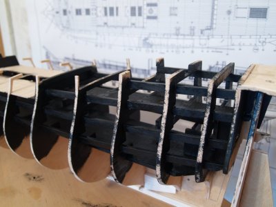

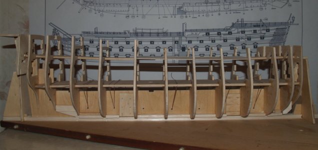

For 12 hours straight, not a minute less, I worked on the hull. Glue in hand, excitement in my eyes, and by night (having started in the morning), I had a completed hull in front of me.
Now, let’s go step by step.

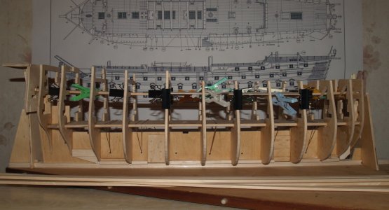

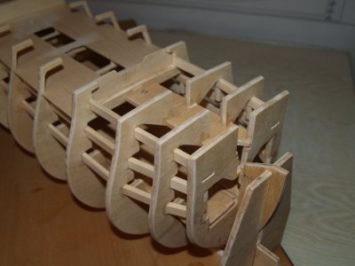

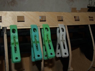

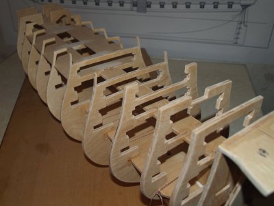

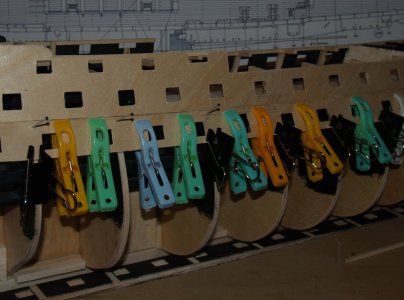

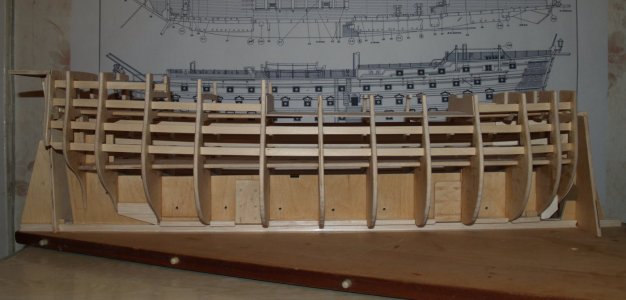

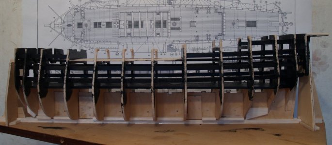

First, I placed the keel into the slipway. I installed all the frames, gluing them in place. After reinforcing them with parts No. 15 and 16 and installing the decks (to check for any misalignment), I generously applied PVA glue.
As you can see, my clamps were nothing fancy: regular clips, clothespins, and string threaded through pre-drilled holes. I also installed spacers along the entire perimeter of the keel. This added extra rigidity and ensured the keel wouldn’t warp. For spacers, I used balsa wood 6x150 mm, placed between each frame on both sides.
When the glue dried, this is what I ended up with!

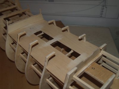

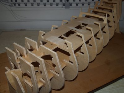

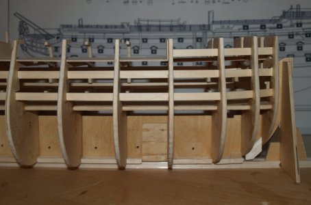

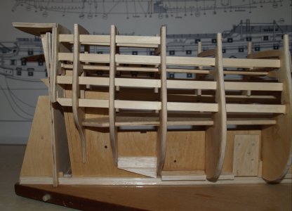

Next, without wasting time, I got to work on the false gun rails. These are strips measuring 5x10 mm that needed to be glued into the grooves of the frames. I did this by holding the bend in place with regular thread, tying the strips to the frames.
At the front and back, it was impossible to achieve the curvature, so the strips in the front and rear frames were cut and bent to the desired shape.

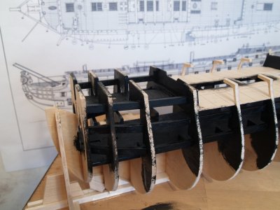

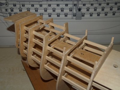

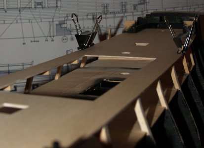

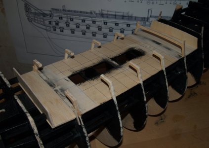

I also glued the side walls for the lower deck.
P.S. I want to mention in advance that I extended the lower deck, so these walls will be fixed in a different location than you see here. To do it right from the start, scroll a bit further ahead. Overall, I recommend making this deck completely, i.e., without false cannons. The deck level is marked on all frames... In other words, do it the way Jotika suggests. I would have done that, but it is what it is.
By the way, in places where the hatches are located, the frames need to be trimmed (specifically the 5th, 7th, and 11th frames). However, do not cut the area for part No. 16 in the 6th frame, as this is where the two sections of the lower deck connect.
With euphoria in my heart, I barely fell asleep after the work I had done. The thought of painting tomorrow kept me wide awake.
(Oh, by the way! What you see now consists of 91 parts. Just for the record.)

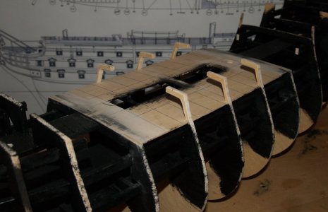

I didn't expect the paint to take so long to dry. But patience is running out, so I took a photo as it is. The paint is matte to avoid any shine. In reality, after drying, there was no gloss at all.
The total number of parts at this point is 100.

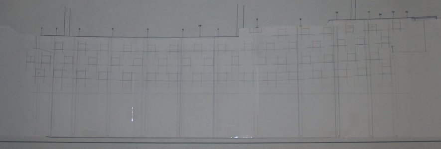

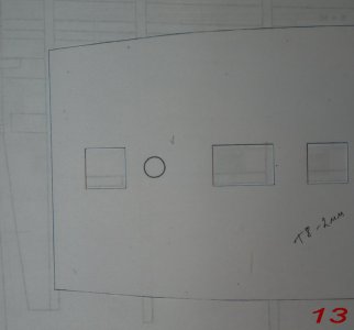

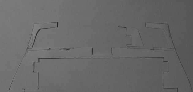

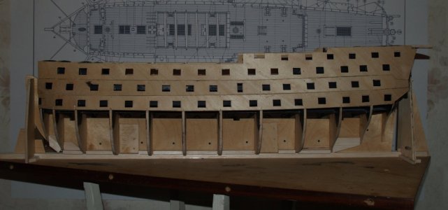

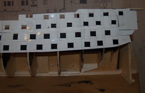

Until 6 a.m., I was calculating the placement of the gun ports, but still didn't manage to finish everything.
At first, I calculated everything on paper according to the drawings.
But the drawing, as you understand, is a two-dimensional image, and when fitting them onto the model, some adjustments were made.
*By the way, I would like to point out that on the battleship, the gun ports are NOT the same size! They vary in dimensions (see image below).
Only by morning did I manage to transfer everything from the templates to the wood. These are the so-called intermediate templates. I find balsa wood to be an excellent material for this, but cutting across the grain was quite a challenge. I had to cut along the grain first, then "crumple" it with some extra margin (that's the only way I can describe the process), and finally, finish it off with a file.
In the end, here's what I got.
Minor adjustments were made, and the topic was covered.

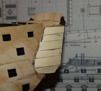

As you may have noticed, I didn’t choose the option of "poking" the gun ports into the finished planking. Instead, I preferred the method suggested by JoTiKa.
Yes, it took me a day and a half of calculations, but the result impresses me greatly. The main advantage of this method is that on the template, you can correct everything, bring it to perfect accuracy, and have access from the opposite side (to control the alignment of the gun ports with the planking for the cannons).

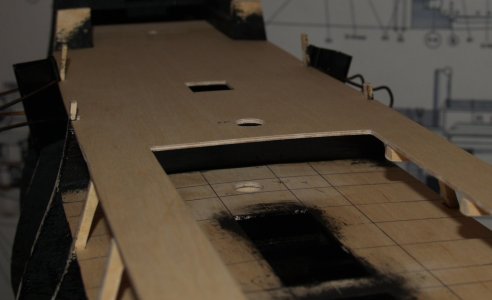

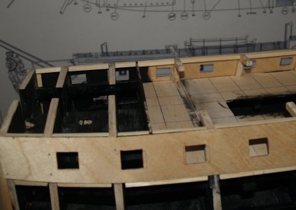

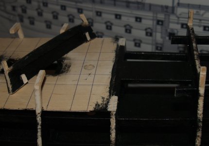

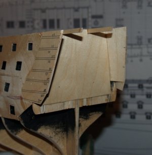

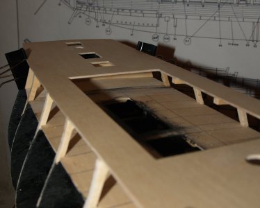

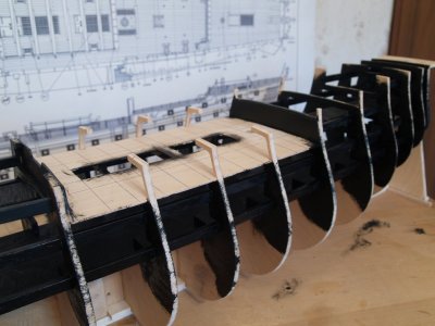

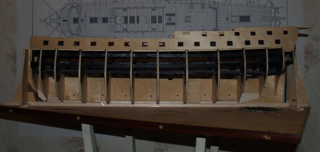

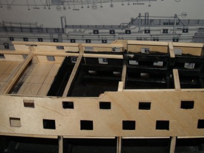

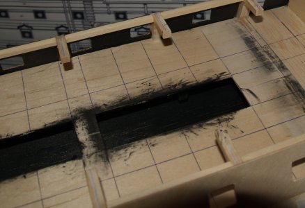

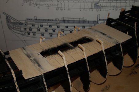

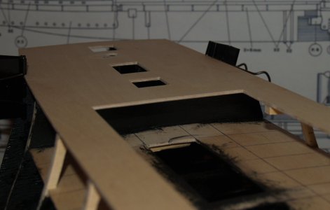

But before cutting out the ports, I made some initial changes. I noticed that when the upper deck is placed, the walls of the lower deck would be visible. So, I decided to move these walls one cannon port further out on each side.
I cut part of the frame, leveled the deck, and then added partitions and sections of the frames.
The result—I liked it. The walls are almost invisible. And the part that remains visible will cover the edge of the floor and the beams that will support the boats.

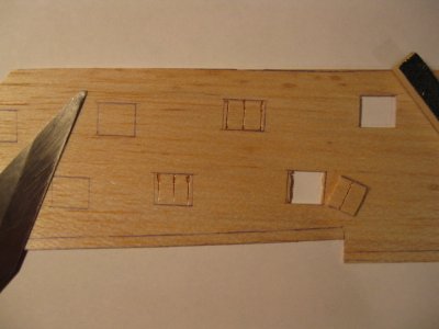

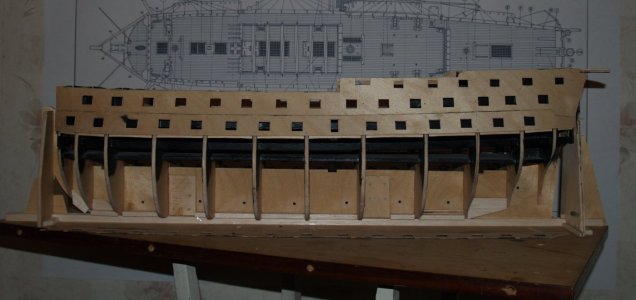

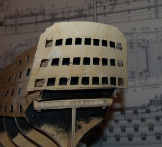

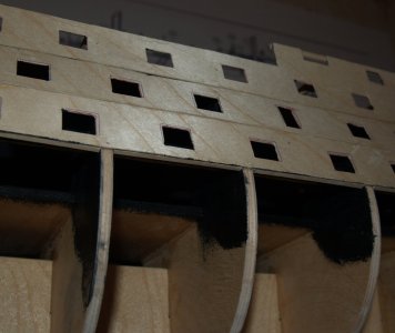

After that, I returned to cutting out the ports.
Then I painted the inner surface, except for the strips for the glue, as well as the reinforcing strips.

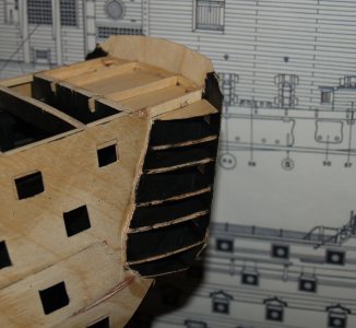

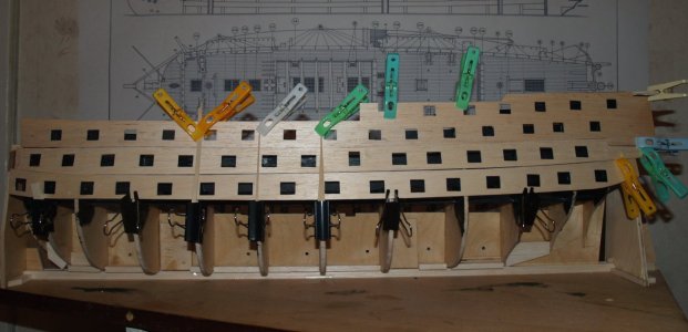

After the final adjustments, I started gluing these plates onto the hull.
To strengthen the connection between the plates, I glued wooden inserts.
I also reinforced the upper edges of the plates to prevent breakage.

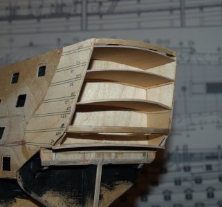

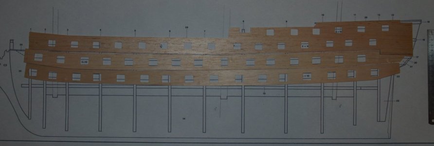

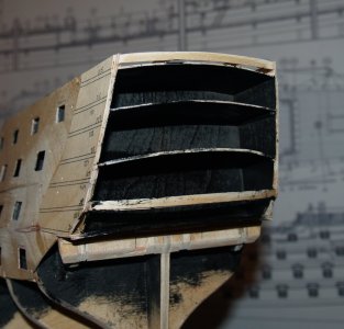

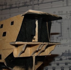

After that, while I had access to the very bottom deck, which was not included by Mantua, I glued in a simulated deck. I painted it black so that it wouldn’t be visible. The stairs will descend onto it. I installed these false decks onto pre-glued beams.
In the photo, it's hard to see; everything is black. But that’s the plan. This joint will be better showcased later.

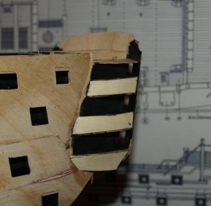

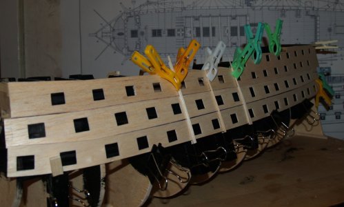

Then came the second belts with their inserts...
...and the third. Here, I also reinforced the lower edge. This will ensure a good contact with the inserts that will cover the rest of the hull up to the keel frame.

This concludes the first part of the rough sheathing. There are 242 parts on board.
To be continued...

So, the stern.
I can definitely say that the option suggested by the kit manufacturer, Mantua, was absolutely unsuitable for me!
So, I cut that horror off to the root!
Armed with the drawings from Jotika, I cut a series of parts to assemble the stern frame. (I’ll repeat, at that time I still hadn’t realized that everything needed to be done according to the anatomy, but that will come soon). I left only the two side vertical walls. I decided to make the inner ones hollow and assembled. On the sides, there are tabs where the side part of the stern will be fixed.
Then came the outlines. After calculating the stern's sag, I made them, along with the supports for the decks.
After that, I could install the simulated decks. Additionally, in the last frame, I angled the lower edge to create a smooth transition from the stern section to the hull sheathing.
Then, I painted the interior...
...and finally, I glued the front wall of the stern. This is just the rough frame; it will be covered with the finished cladding.
The next step is the side parts of the stern.
12.2009
For five long days, work was carried out on the frame of the stern. The work on the side parts took a considerable amount of effort. First, I had to cut and glue the ribs. I borrowed them from the Jotika drawings, calculating the exact scale.
Then, everything needed to be painted and left to dry completely.
After that, individually calculate and glue the walls. First, the "balcony" walls, where the columns will be placed in the future...
And then the "window" walls. I would like to note that they will remain solid only during the puttying and sanding process. After attaching the finish planking, holes will be cut into the "window" walls for the windows. More details will follow later in the review.
Finally, the lower contours were added.
That’s all for the stern section for now. Next up is the bow section.
