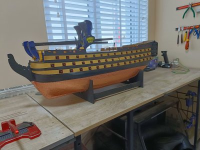

HMS Victory by Caldercraft (10 months in )
  • Thread starter Thread starter Bri62
  • Watchers Watchers 56
Bri62 That is just beautiful build progress I can see this being a Exhibition piece once finished, only wish I had the display space to build the Caldercraft kit.
Pulled up a chair and will be watching for the incoming updates.
Appreciated and your welcome get comfy will be a long one :)
Bri62, nice to meet you.
I've been following your Victory project from the very beginning.
Your craftsmanship is incredibly meticulous.
Your Victory is truly magnificent, and the careful work of attaching the copper plates is superbly executed.
Awesome!! :D
Hi guys well what can I say sort of burnt myself out on this one, had a rest from modelling as I lost all interest, but I think I found my mojo again and will be resuming the build soon ..............see you soon
Building 1:72 scale Victory model may become discouraging at some point when one realizes how huge it becomes. When finished it require a display case at least 5 feet long, 3.5 feet tall and 2 feet wide. Even if all is complete the question remains where to find a space to display it.

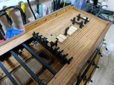

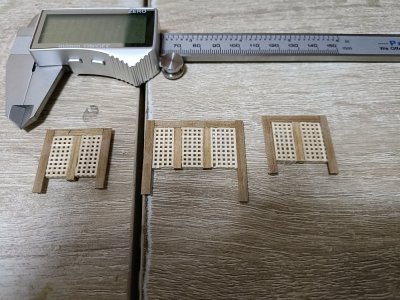

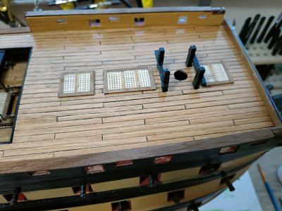

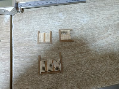

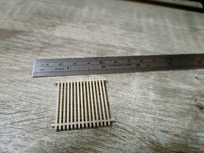

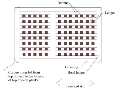

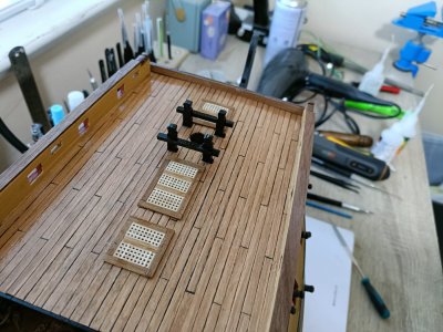

I have no idea if this is important to you but the battens ran fore and aft, not athwartships. Most observers will not notice I'm sure, but was not sure if such details were of interest to you.

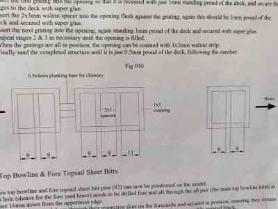

I am just following the plans included with the given materials It actually didnt say which way they ran

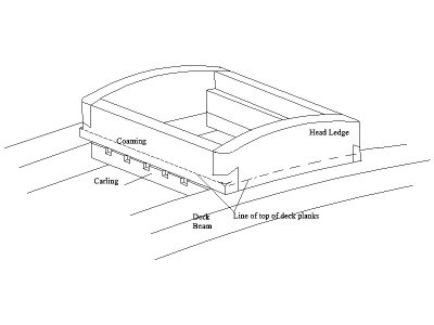

I totally get that they do not show many of the details correctly. Not a bad idea to check other sources to compare where short cuts are taken with many kit manufacturers, IF this kind of thing is of interest, kit makers often claim historical accuracy, but these are often false claims in some cases Again, this may be of no importance to some folks, as the fun is in the building the ship out of the box. If it is fun it is a success, that is the main point of any hobby. FWIW the coamings and gratings stood proud of the top of the deck planking varying amounts. For Victory in 1803 when she was rebuilt, the coamings and head ledges would have conformed to the 1795 stipulation by the Navy Board that coamings were to be built 15-18 inches above deck level, to prevent water from going into the openings. At a scale of 1:72 this would be over 5mm.
