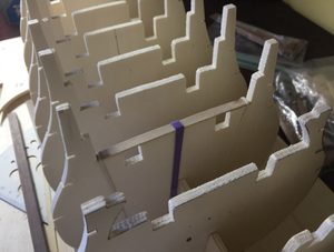

This evening was dedicated to adjusting 18 frames vertically in order for ship hull to have a proper body curvatures. I want all curves of my model to be smooth with no bumps. This is probably one of most important operations in building of a hull of a kit model. This is very difficult to do with these 18 manufactured frames as they cut very inaccurately - I would say they are cut all over the place. It is a shame to have them cut so inaccurately in the age of CNC machining. Because of inaccuracy of frames I have difficulty to decide which reference points to take for vertical adjustment. Frame common reference points to select can be:
a) surface for attaching a deck?
b)a side line going through notches cut for attaching cast gun ports?
c) the frame very bottom points?
I put all frames into a keel and sat with the model for many hours measuring, re aligning and vertically re positioning these frames. I found that none of above reference points can be taken as 100% reference. I had to come up with a compromise which makes a), b)and c) references to be not too much off practical sense. Below is a picture showing what I came up with. See the thread inserted into gun port notches. The thread curvature aligned itself not so badly. Each frame bottoms are not much too off as well. Top surfaces for gluing decks are not 100% level but are going to be pretty easy to fix with filing the wood off or adding some wood on a few frames. This is the way I will glue this together tomorrow. Have a good night.
