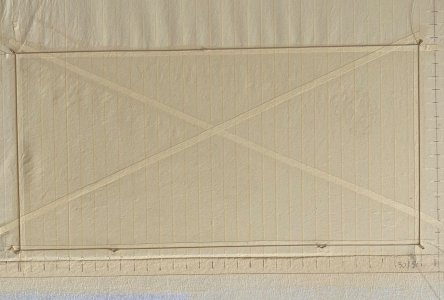

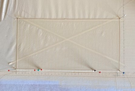

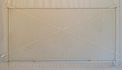

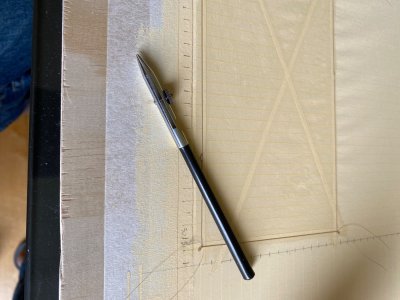

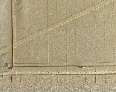

Looks as fantastic set. Peter. I used a similar one in school but now I don’t have it. Should watch eBay to get some. The older the better. To draw the sail seams lines I bought just a new ruling pen for a few bucks.
Hello J.T. It looks extreemly good, the line that you made with the ruler pen looks amazing. Would you please share this ruler pen image please?

Clever idea and the results are really good. Like Etubino, I am curious about the ruling pen. Are the below what you are referring to? Just want to be sure before buying some.

Hi, Eduardo and Allan,

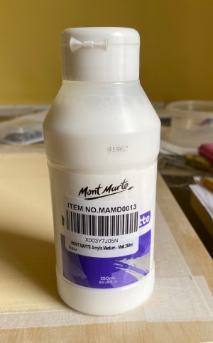

I just posted a picture of a ruling pen above. When buying one make sure it is not too small. The bigger the better so it is able to hold more paint. I started with a smaller one. I was not able to draw more than on line without refilling the pen. Note that you will have to clean the pen after drawing about three lines so it continues to release the paint. I clean under running water with a toothbrush. You will have to play with diluting acrylic paint with water. Too much water and paint will make ugly blobs. Not enough water and paint will not flow. It is very finicky stuff to work with.
