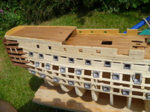

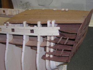

16

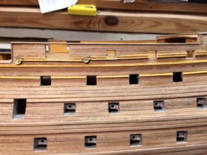

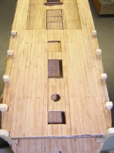

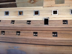

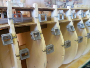

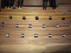

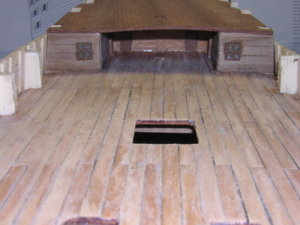

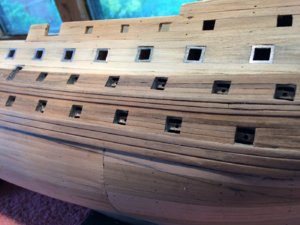

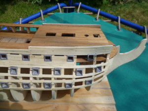

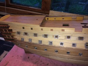

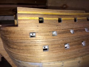

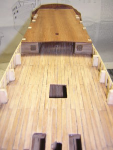

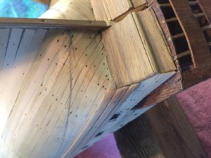

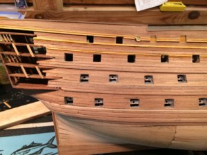

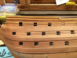

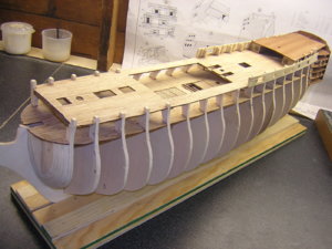

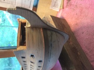

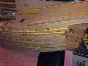

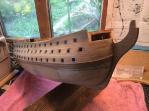

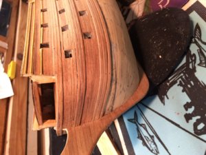

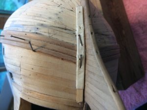

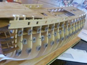

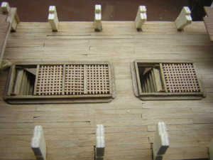

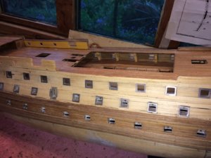

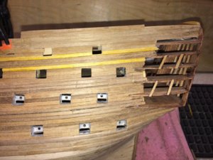

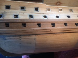

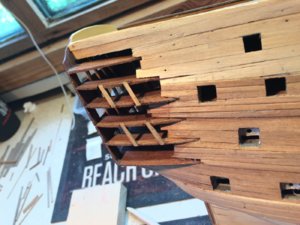

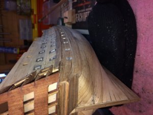

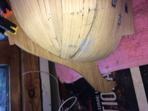

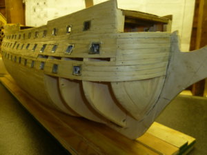

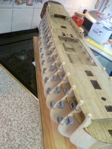

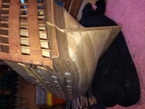

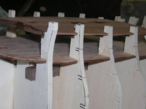

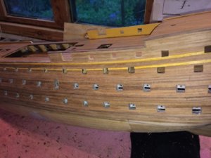

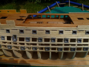

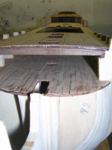

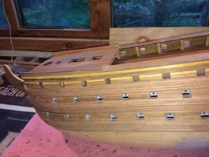

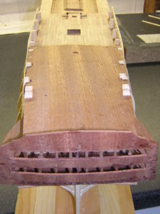

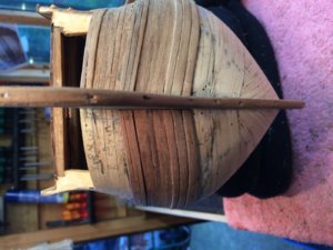

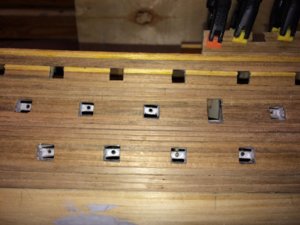

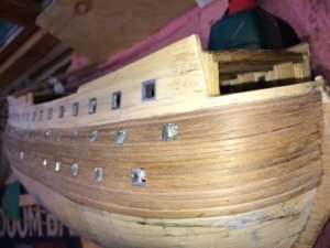

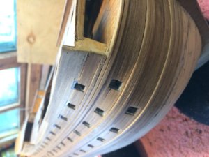

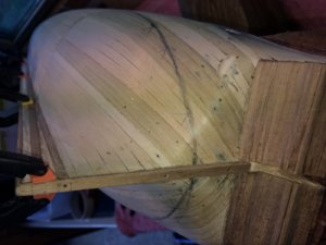

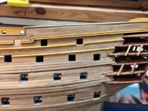

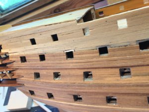

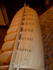

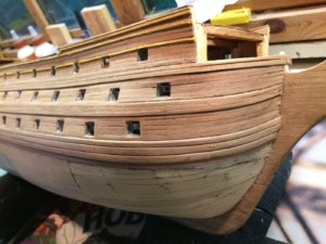

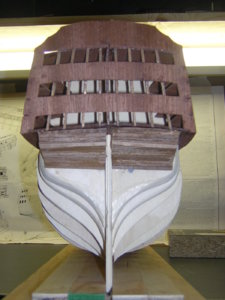

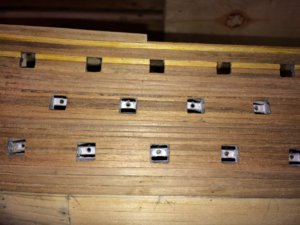

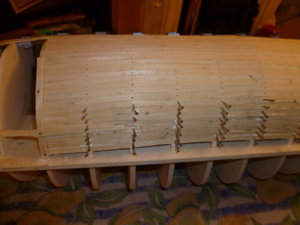

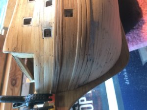

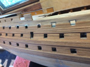

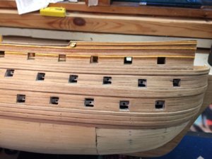

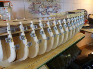

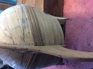

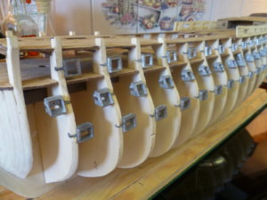

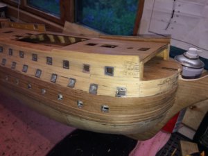

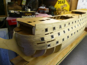

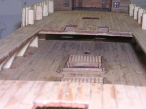

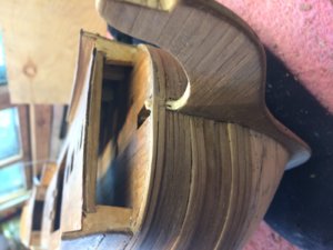

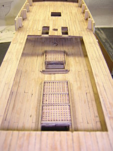

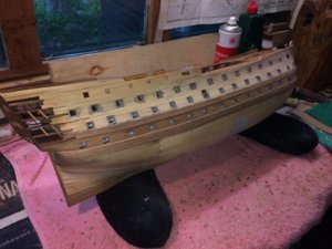

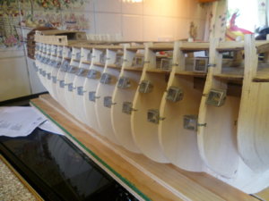

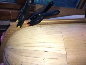

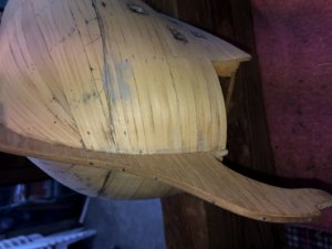

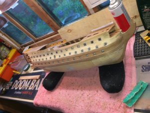

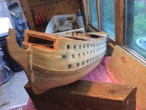

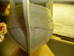

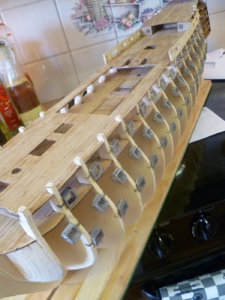

Started the build back in 2005 when my son was born, put about 90 hrs in then we had a secondchild 2009 so the boat went on hold. We moved house in 2013 and I moved my big shed with us and set it up as a proper Man cave (boatshed!!) said "right. I can start the boat again" to which the admiral said "not till you have done.... Attic, kids bedrooms, bathroom/toilet into 1 room, big BIG kitchen/diner extension on back of house.." Finally, about a year and a half ago I got them all finished, so off to the shed I went. Admiral said "what about the stairs hall and landing , and our bedroom"?? Not on your list, so they aint comin in!!! after 6 months and another 60 hrs work I put her back in dry dock and told the boss (Admiral) I would finish the 2 outstanding jobs. Just about finished the hall/stairs but the master bedroom can wait.. Here are a selection of pics showing my build so far. Apologies fir going back to day 1, but that is what a log is for isn't it.DSCN0689.JPGDSCN0691.JPGDSCN0692.JPGDSCN0693.JPGDSCN0694.JPGDSCN0695.JPGDSCN0696.JPGDSCN0697.JPGDSCN0699.JPGDSCN0700.JPGDSCN8656.JPGDSCN8658.JPGP1000948.JPGP1000949.JPGP1000950.JPGP1000951.JPGP1000952.JPGP1000953.JPGP1000955.JPGP1010441.JPGP1010442.JPGP1010443.JPGP1010444.JPGP1010533.JPGP1010537.JPG

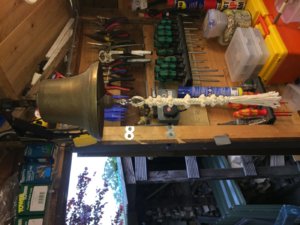

Hi Maarten, thanks for your reply. New to this, just put my pics on so you admin guys can work your magic. They dont look too bad full size do they?! Am following one of your members (YT) a lad from Canada, on the other site I am on, his work is truly inspirational. Hope mine comes anywhere close to his. Mind you, as an ex AB in the UK merchant navy, I am only really doing the boat to do the rigging... I make bell ropes and knot boards as well, put a couple of pics in with the boat of my work.

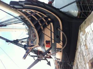

In removing a piece of the original wood from Victory they discovered the original colors it was painted. Now the ship has had its original color restored and the strongly colored ochre bands are gone. I have photos (from about a year ago) but don’t know how to send them to you. Or maybe you don’t intend to paint it (?). Mike

Cheers mate, I have hundreds of pics from a visit there in 2016, as well as a visit back in 2011. I bought a set of the paints from cornwall model boats when i bought the kit. I am going to paint one side and do the little green tiles, and the other I am going to plank all the way down from the waterline to the keel, and leave that side wooden.

spider, when you did the deck planking, did they give you enough? I'm just starting same.
ken s
Well-Known Member
Nov 10, 2019
127
78
I did the math.... seems like they gave me enough....... just barely.... have to be conservative.

Are you going to tile the bottom or plank?
Hi Ken, I was originally going to put the little green tiles on one side and paint that side black/yellow, then just plank the other side all the way down to the keel, and wax the side rather than the colour scheme.
Now however I have bought some rolls of copper foil see this link: https://modelshipworld.com/topic/486-copper-imitation/
and am gonna put the green tiles on first, to get the pattern right and put the foil over the top of them, I think it looks awesome compared to the tiles, but is a little too thin to just put it below the waterline alone.

Hi, spider,,,, i'm currently just started the tiling..... it's sloooow going. There is a certain pattern. There are supposedly TWO bands of plates running horizontally. Not just two rows. Two bands of several rows together...(make sense? kinda?) you just have to pick a point somewhere in the middle to start the second band. Look real close at YT's. I've done alot research on this and not a whole lot of info. Like everything else, it's all tapered, just like the planking. You have to think 3d. I'm doing all that can be done b4 I start the enclosed guns, as I will be adding those at the last possible moment b4 the upper deckings., I'm going to try the tiles and paint with testors model copper and see how that looks. If not, I will go the tape route. That stuff is very delicate and damages easily. I have some from when I was doing stained glass. Keep me posted

Look real close at the full page layout (A) toward the bow. You'll see those two bands. I think in the instructions (right in the middle) it says do 13 rows from the water line, then new band, as that is the actual count. At least that's how I understand it. If you come up with some thing different, let me know.
