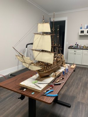

Coming along nicely. I had some issues with some of the cannons as well. While most of the openings worked pretty good I found some issues with the some of the hull ribs being more than in the way, sometimes a dang nuisance.
The kit is called 1765 Shipyard style

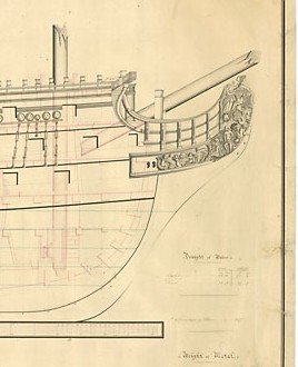

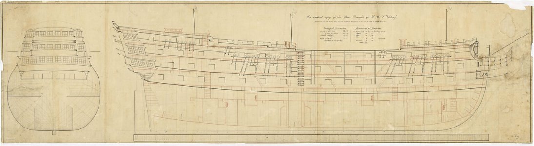

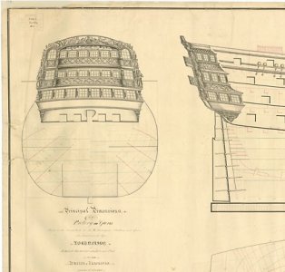

OcCre really should be ashamed. The figurehead looks like the 1765 version but the stern carvings look like the ones after the 1803 rebuild. Either way names were not allowed on the stern in 1765 or in 1803. They got the number of stern lights wrong. Based on Victory 1765 contemporary drawings there were 8 at each level in 1765. They show 9 like after her rebuild in 1803. They did not even get the wales in the correct location.
As you said, most folks would not know the difference or care, the thoughtfulness on presenting such a gift is super important. For us as builders though, we should not ignore such basic errors from a supposedly professional kit designer.

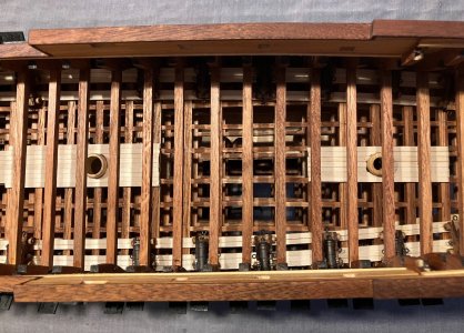

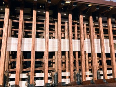

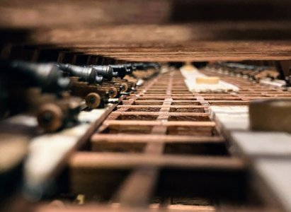

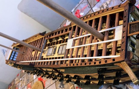

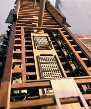

This week I added the 2nd level of cannon hatches and started with another floor. The visibility of the cannons on this and the bottom deck is poor from the inside of ship, and therefore there is no need of details (like rigging).
Anyway, I'm happy with how the ship is starting to look.

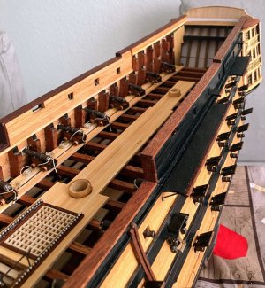

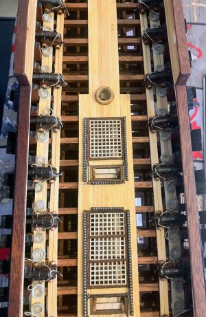

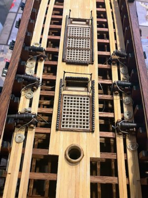

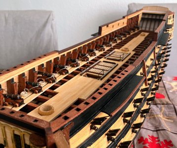

This week, I have made a new batch of cannons for the next row. The cannons are a bit smaller than the previous ones and will have a bit more details with ropes. Also, I created the deck with lower the grids than what is described by the manual to have them almost flush with the deck.
The cannon balls, I managed to glue in a straight line by placing them first on a gutter like jig, and afterwards fix them on a tacky support.
Coming week I will continue with fixing the cannons.

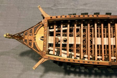

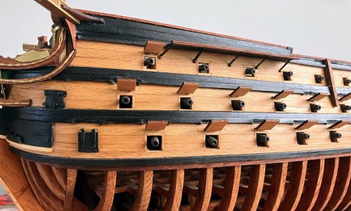

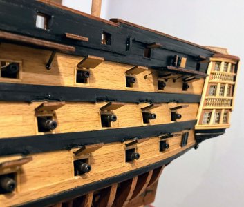

Cannons look great. Question. Did you have any ribs of the ship in the way of cannon openings. I had 2 or 3 and made it work but was wondering if it was something I did wrong or is part of the build to trim some ribs.
Some ribs need to be cut to make space for the cannon openings. Since the spacing between the ribs doesn’t match the spacing between the cannons, this is inevitable and by Occre’s design.

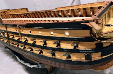

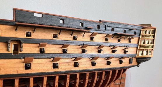

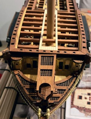

This week, I have finished placing the third level of cannons and the cannon hatches. Also, I put some 'wings' on the hull. I'm happy with my choice to make them black. Next step will be putting in another floor.

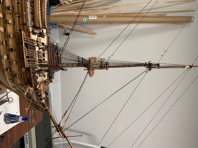

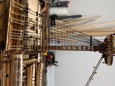

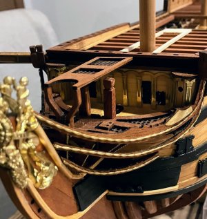

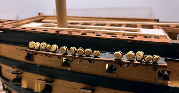

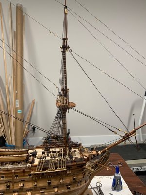

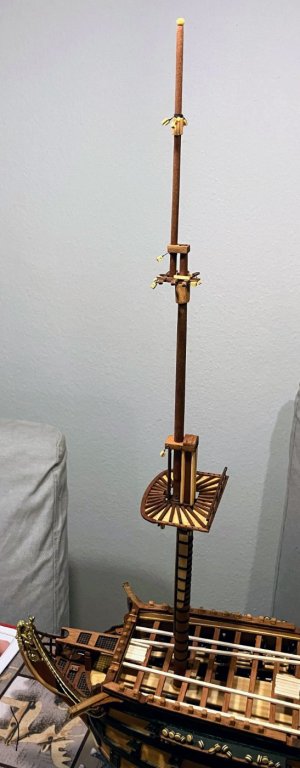

Another update of a weeks progress: Next to adding some small stuff in the front and hull, I have put in the next level of beams for another floor. However, I will not finish this floor at this moment, and switch to creating masts first. In this way, I can fix the masts first, and afterwards fit the floor tightly around them. Also, I have improvised a bit with the oak beams to create the loading area in the centre of the ship. Since one half of the ship is open, I think this will be a nice visual when it is finished (eventually).

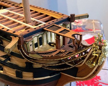

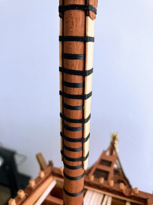

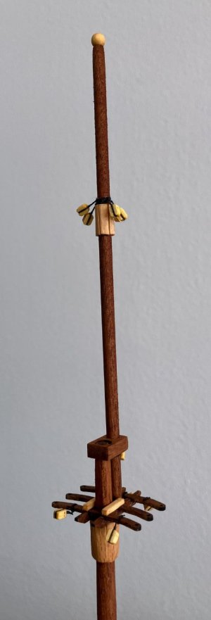

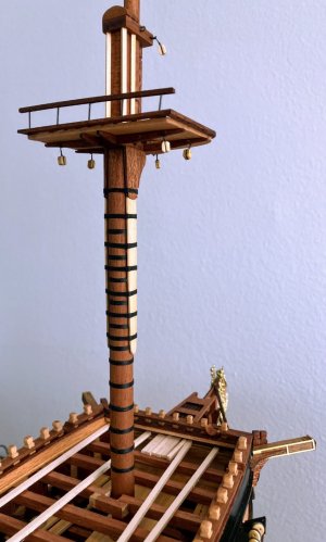

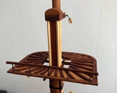

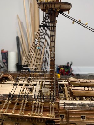

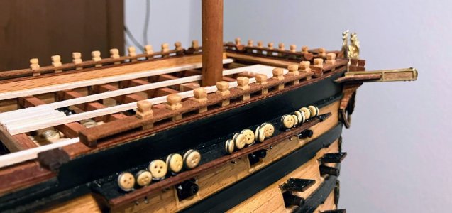

This week, I have been working on the railing in the front. My skills and patience result in a limited repeatability of the pillars of 2 and 3 mm wide, mainly since the lime-wood is so very soft. Furthermore, I have started working on the front mast, which is a bit more detailed, but still very similar, to my previous Occre builds (like the Beagle).

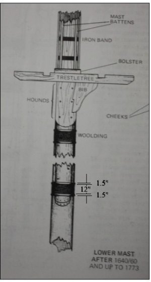

Just as an FYI for the future, as it was mentioned earlier this the 1765 HMS Victory, all the wooldings went over the cheeks and had 1.5" wide wooden bands to protect them. The largest ships had no more than nine wooldings. After 1773 iron bands were added in between the rope wooldings that went under the cheeks. In 1800 rope wooldings were no longer used but had been replaced with both iron hoops and iron bands.
From James Lees' The Masting and Rigging of English Ships of War
