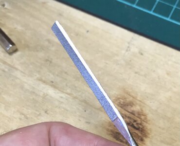

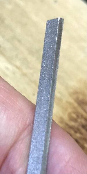

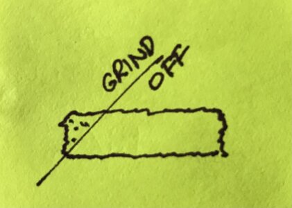

Here I modified my diamond file. Look now it can do very sharp inner corners. Boy. It had been very difficult to grind off this diamond file. Two grinding sandpaper disks were gone plus a lot of work on a large hardened file was done before I finished grinding this little diamond file.

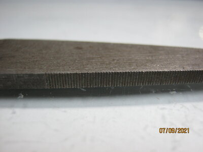

maybe making the file also by yourself
This is actually a great video of a man's craftmanship! But... how many of us can actually do it (if any)? The cost of the equipment itself, the material cost will mostly void trying it.
