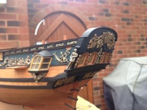

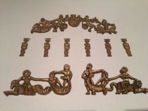

When Building Panart's Royal Caroline I was determined to make the best of what was supplied.The biggest issue was the thickness.I removed material from the back of the castings to reduce their thickness by half using a sanding disc in an Angle Grinder and care.Some ended up very fragile.The ones that went on to curved surfaces I took a mould from and recast in resin.These could then be placed in hot water and shaped to conform to the curves.The cast figurehead was refined with rotary tools which as it was cast brass,was slow work.
The biggest thing I would say is as the material of your castings is unknown,wear gloves and a mask when working on them,if there is any Lead in there it won't do you any favours.
I include some pics including the reworked stern castings and prep for moulding.
