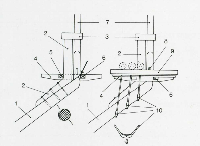

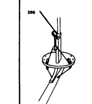

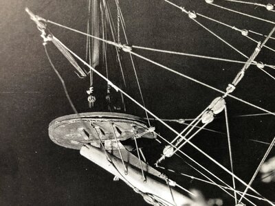

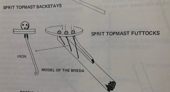

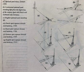

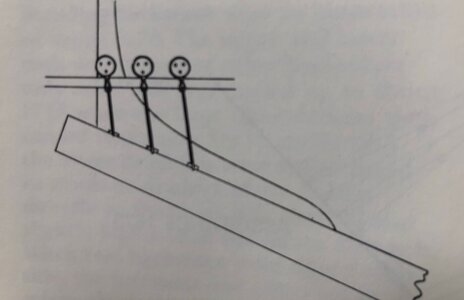

Hello, here I found some images from my books. Deadeyes are tied to chainplates, and chainplates tied to bowsprit.
Thank you. Do you have a picture of the chainplate that is used specifically for this application?
I have to look if I have specifically chainplates images. They should be similar to the chainplates used in the ships from the same era, they just bolted to bowsprit instead of hull.
