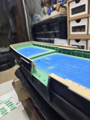

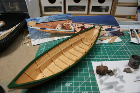

The photo below is my current project. Airbrushed the bulwarks a few days ago (enamel paint). My point with the photo is the lack of paint overspray, no spitting or running. I test start with the lowest air pressure and adjust until it's a smooth even flow. When I built the Dory I was going to use Manufacturer recommended acrylic paint but decided to just mix my own batch of enamel.
Again, this is just my experience, lots of trial and error.
