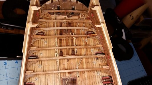

There are so many ways to display the anchors and anchor cables on model ships. I'm looking for advice from someone who knows a bit about anchors and their deployment. On my last model, I displayed all four anchors on the channels, each connected to their individual anchor cables. On my current model, I was thinking of displaying the forward bower anchor as shown below, in the process of being retrieved and hanging from the cathead hook. The anchor behind it would be stored as the one on the right, lashed to the anchor to the channel. Why there already is a forward bower anchor on the channel, I have no idea. There is no place left to store the anchor they are currently weighing! Keep reading below, I'm just getting to my question. .
As you can see, the port forward anchor line is rigged with a messenger (vyol line) as if the anchor is being lifted. The starboard forward anchor cable has a turn round the bitt and stoppers holding it to the deck, and its anchor will be stored on the channel.
Question: were the aft anchor cables often left attached to their anchors while those anchors are stored on the channels? If so, would have to run more cables on the deck and run them down the main hatch and down to the orlop deck, and those extra cables would clutter the deck up quite a bit, interfering with the anchor weighing operation in progress for the port forward bower anchor. Should I run a second cable for the after starboard anchor and leave the after port anchor with no cable attached? Looking for some opinions here guys....1644098213121.png Please help.
