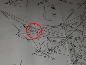

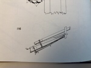

Need help attaching the topsail yard to the HMS Victory bowsprit? On the main yard you use a sling but I can't find anywhere how to attach the top one to the bowsprit.
From the drawing below, it looks like the yard moves forward and backwards because there is a block attached to the front of the yard.
Take a look here in this document at page 64
and also here you will find good information

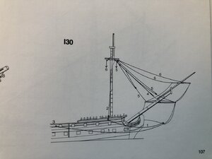

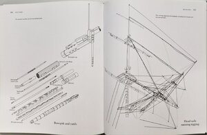

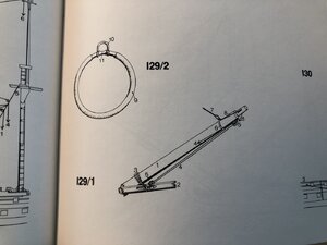

I just made some photos for a book review about the Anatomy book of the Bellona, a 74 gun ship of the same period like the Victory
Building the Mantua Victory I recommend to buy the Anatomy book about the Victory, where you can get a lot of information necessary for the masting and rigging
and also the book by Alan McGowen
f.e. already shown in the book review
