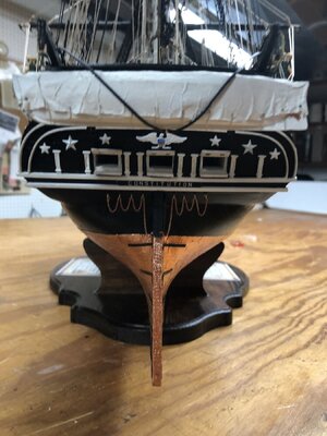

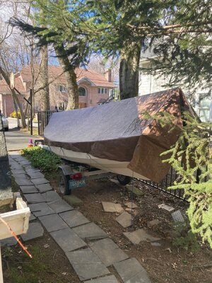

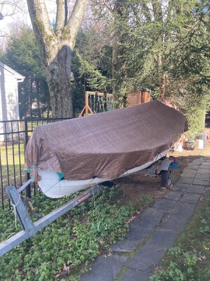

Hard to find much on this but perhaps these will help. Not from 1805 but I don't think practice on covering boats has changed that much (except for blue shrink wrap). The first photo is from "The Visual Encyclopedia of Nautical Terms." Fair winds!
One more pic. This is a photo of the Macquarie (ex. Melbourne). She was an iron-hulled clipper built in London in 1875. Sailed the London to Australia route. Pic is from "The Merchant Sailing Ship: A Photographic Survey" by Greenhill and Giffard.

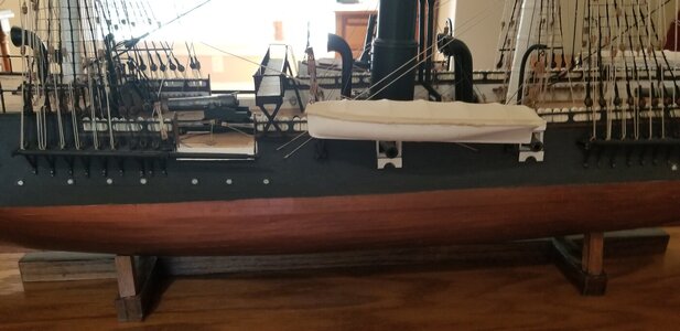

I used an elmers glue watered down solution and kleenex for my Housatonic. It drapes and wrinkles nicely.

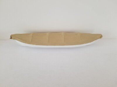

I used a single layer of tissue, just one ply, wetted with dilute PVA glue and draped a rectangle of the right size over the boat. It draped perfectly. I then painted a second coat of PVA "dope" then a final coat of tan paint.20240302_101335.jpg

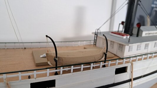

What I did was glue a frame outside of the boat about at the length I wanted the cover. Let the tissue hang so you won't see the frame outline. Trimmed it just below that frame after it was dry. One tissue is enough. The ribs you see is 20 ga wire. The frame is about 1/32 thick. Nothing fancy underneat the cover. This boat is 5".
