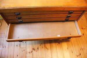

when the plans are flat a very good way to store them are such a closet if you have the space for it - sometimes offered used and cheap

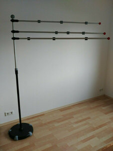

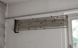

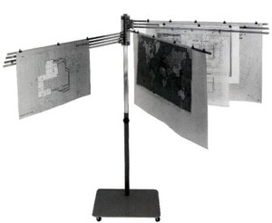

If you use them such holders are often helpful, especially if you have to take a look on several drawings parallel - also here used ones are often offered
