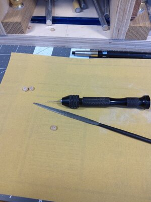

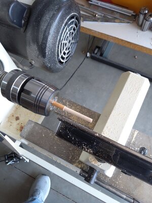

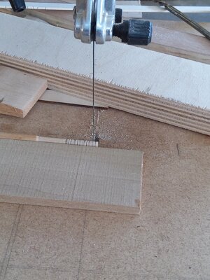

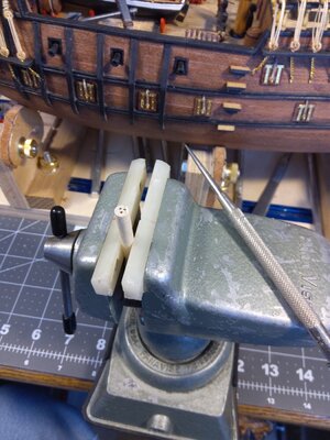

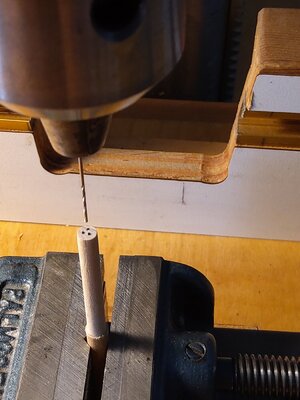

I made deadeyes with three holes but they were into endgrain. Deadeyes are actually edge-grained items. End grain would not sustain the forces I don't think.20210816_154623_020.jpg
you are right - the method shown is a very simplified way - therefore I made the earlier post to clarify this also for the beginners in our hobby

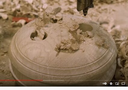

Here a photo of an original deadeye in scale 1:1 under production after drillling the holes
Take also a look at this highly interesting video
This is interesting. The hole pattern is different than I thought. Also judging by the size of the groove for the shroud, the deadeyes are quite a bit thicker than the size of the shroud.

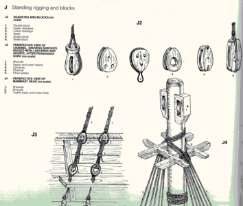

Attached is information about the deadeyes of Columbuses ships. His expedition was in 1492 my model is from the start of the 16th century. May I suggest reading the book SHIPS CHRISTOPHER COLUMBUS REVISED (Anatomy of the Ship) Link https://www.amazon.co.uk/SHIPS-CHRISTOPHER-COLUMBUS-REVISED-Anatomy/dp/1844860140/ref=sr_1_1?keywords=SHIPS+CHRISTOPHER+COLUMBUS+REVISED+%28Anatomy+of+the+Ship%29&qid=1638915092&sr=8-1
Many Thanks for posting this excerpt from the Anatomy book, which I have also in my library.
Ok - as I understand, you are making "hearts" for the shrouds. Deadeyes are the type 2 and 3.
At the yardarms blocks were used.
I learn something new everyday. "The three-holed blocks were called deadeyes because the position of the three holes resemble the eye and nose sockets of a sheep's skull."
