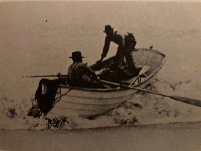

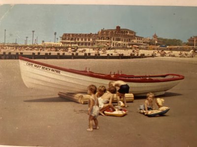

I'll begin with a couple of assumptions: 1) you're referring to the Midwest Sea Bright Dory, and 2) you're planning on putting on the topsides "Atlantic City" or something similar as illustrated on the Midwest box. It may be tricky to get a decal to lay flat and look good on the strakes of your model per the box art. However, there are alternatives. You could finish your model as a fishing boat instead of a lifeguard boat and eliminate the lettering. The first photo* below shows a Sea Bright skiff as used for fishing around 1907 (they were used for fishing before they were used by lifeguards). Note that this skiff has traditional straight wood thole pins in lieu of the curved metal ones on the Midwest model. Those are a more recent development on lifeguard boats. The second photo shows a lifeguard boat with the lettering confined to the sheer strake where decals shouldn't cause any problems. This boat has thole pins and a snazzy red rail. Have fun and please post some pics of your model.
Fair winds!
* photo from "The Sea Bright Skiff and Other Jersey Shore Boats" by Peter Guthorn
