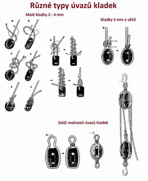

As for tying blocks, here are some ideas:

Darivs, thanks for show us the pulleys and tyes drawings. This item really makes a difference in the visual quality of the models.

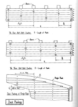

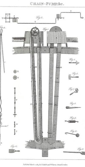

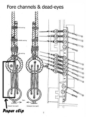

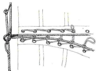

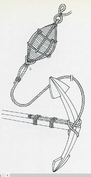

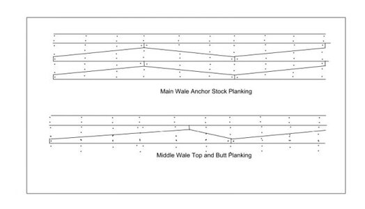

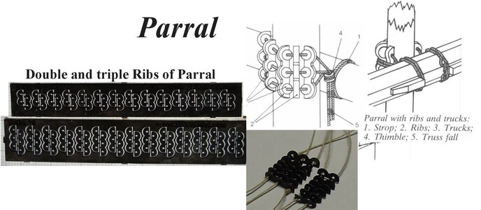

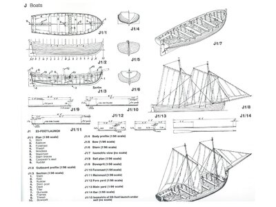

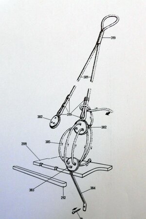

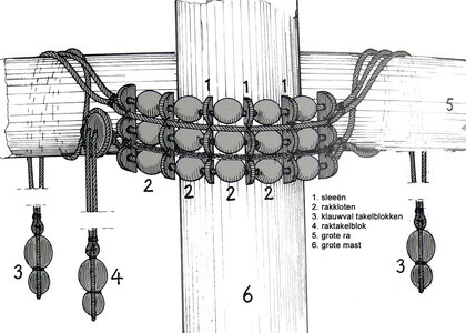

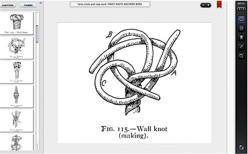

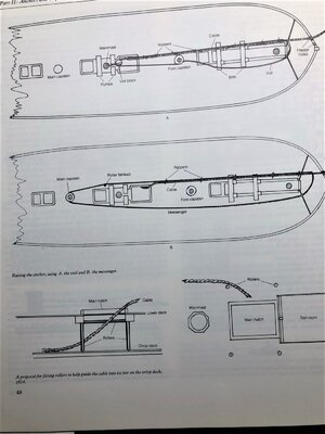

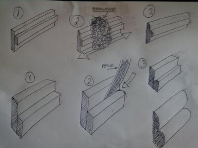

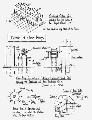

No problem. There are lots of useful modelling how-to pictures on the web. I've collected quite a few for reference for ship features. Here are some of them. These were instrumental in learning how to make the basic parts of my first ship model.
Deck Planking Styles.jpgAnchor Buoy 4.jpgAnchor Handling Gear.jpegAnchor, Top and Butt Planking styles.jpgBonnet lacing 2.jpgBonnet Lacing.JPGCannon Carriage design.jpgChain Pump Types.jpgChain Pump.jpgChannel Profiles.jpgDutch Parrel rigging from Prinz Willem.jpgfore channels__deadeyes_with_arrow_.jpgFraming.jpgLaunch anatomy.jpgMaking Fancy Wales & Railings.jpgMartnets - Continental (French) style.jpgParrels.jpgRope (Right hand Z) & Cable (Left Hand S).JPGSail Parts.jpgTying Deadeyes.jpgWall Knot for sail corners.jpg
