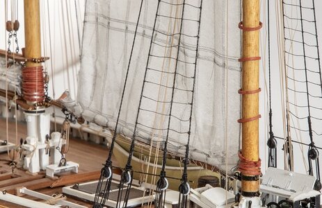

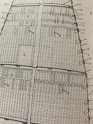

Can anyone explain to me ,how the Reffbaendsel are used in practice ( I don't know the english term of it, it is numbered as 4 in the attachment) .
Actually without this baendsels the sails look boring. IMO they give a nicer look and make the sails more attractive for the models.
Many thanks in advance for the responds

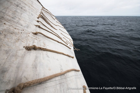

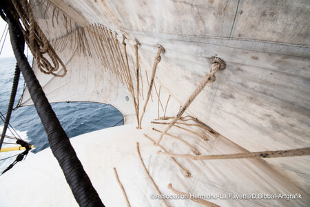

Here two photos of them on a sail of the Hermione, the photos are showing them from both sides of the sail - reef points or bendsel
When reefing a sail at the yard, the so called square knot or reef knot was used

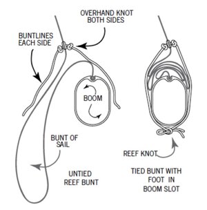

Many thanks for the very very detailed info-material about the sails.Actually I want to know whether these bendsels are used to repair the damaged sail parts to put or connect the torn parts together ,or for minimising the sail area and how they are used.
usually for reducing the sail area when the wind is blowing stronger

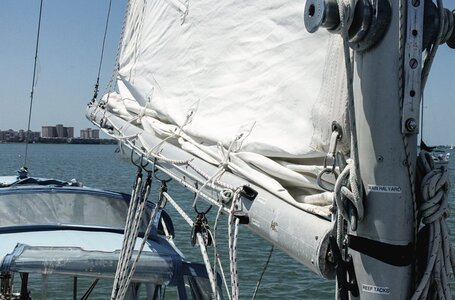

My understanding is that these reef points were used only to reduce sail area in high winds. That is not how sails were repaired when torn. They would have been patched just like you patch clothing and sewn all around.
The reef ties would be used to secure the reef, but not to take it.
tackles are rigged at both ends of the reef band to the ends of the yard, the sail is lifted and stretched by those tackles.
then topmen would trice up and lay out to loosely fasten the reef lines just to control the now loose upper part of the sail, thus avoiding flapping and damage.
very much the same as happens at the bottom of a modern sailboat main sail, only way more acrobatic
