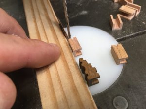

Just as an example,ugly plywood gun carriages are an easy replacement in solid wood once you have read up on how to mass produce the parts on the mill.

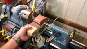

I like the sanding blocks, is that something you’ve made?
The red rubber block is from the hardware store, and the board is, well, just a board with sandpaper stapled to it. :) While the wood spins, you put equal pressure on it from both sides, using both sanding blocks at once. If you sand from one side, you'll soon break a yardarm or flagstaff.

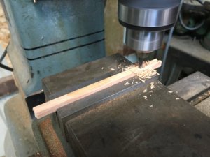

If you really want to cheap out, I've used this little plastic router head:
With proper set up- make sure the work piece is wide enough for the whole head, make sure it and your guide are clamped down solidly, etc- it works OK with some limitations. I was able to mill out some channel stock from some walnut I was already going to cut down into stripwood so wood waste wasn't much of an issue. I was easier and turned out better than trying to do the same thing with multiple cuts on the little Proxxon bench saw, and quicker than trying to kludge something like a dado head for it.

Love the Carriages - Nice !!!

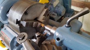

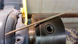

I don't know, Daniel. I'm kit bashing Corel's La Couronne galleon, and I found the lathe to be a supreme time saver making yard arms and mast parts. Planing dowels into perfectly round and tapered parts didn't exactly seem to be an easy task. It depends on your experience using a modelling plane. My experience is in machining, so the lathe was a logical choice. It all depends on the technique you are most comfortable with getting from a chunk of wood to a finished part. Of course, if you make more than one model or have other projects that require more expensive machine tools, the utility of them makes it worth while. I guess that depends on where you need or want to spend your money within your budget.
