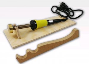

You can try to soak the boards in ammonia rather than water. It is a bit easier. Also you might think about getting a electric plank bender from eBay. Like this.
I bought one from a Hungarian site for about $AUD 70ish including postage.
You get a more spread put heat.
