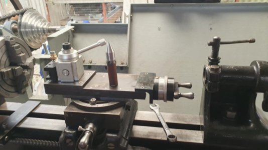

One of my hobbies involves Wood carving and at the moment I am carving 2 horses for a Concord Stage Coach I built. Once the hands start to become sore I have a break and head over to an old - old lathe that I purchased for a very special price that now spending a fortune and time to have going.
You can believe me, I came undone, as it was a train wreck when I first had possession. I finally have got it operably again but it lacks tools and I am steadily making them. How I am doing this I have a Project in mind and it is to build the cannons for the Bounty and you need more than a lathe to achieve them. So I bought vertical Slides for the cross-slide but then the Lathe did not have a compound slide, I thought to save time why not buy one on the net but alas all the compound slides were about 5mm above the center line of the lathe were the closest that would fit. Maybe I could buy one and then machine down the base to fit but warnings started flashing in my head and gave up the idea. So what I have done is built my own and of course, the machining of the slides came at a cost, a good job was done but it all takes time
Carrying along with the Compound slide, what I have been doing is if I need to make something requiring additional work done and I can make it then, I stop the compound slide and make the tooling to make the next move happen.
At the moment I am going to finish building a Dividing system that will help me mark out the dial for the Compound slide.
I need to have a compound slide to make cannons and I need a lot of things done to achieve what I want to achieve.

Hi Robert, yes we have to improvise hugely here. Maybe you can be on hand as I struggle my way through, LOL. However, I have bought the carbide blade for the Proxxon saw. I noticed on a video of somebody demonstrating the use of the Proxxon that when cutting thin strips the workpiece bulk should be on the left-hand side as the guide has allowance to miss the saw teeth at the back whereas he was doing the cutting the opposite way. At the moment all I have done is started the machine up and then put it away.
However, I have just completed the Compound Slide for my ancient small lathe. It would have cost a lot less if I could have found one on the net that fitted to the lathe. So now I can do angle machining. To build the slide, it took over 6 months as it was very hard to find someone to do the Machining for dovetails etc. I eventually found someone who did the machining for me and lived 50 km away on the other side of Mandurah. He did the job as per my requirements which was very different from what I need to have done to the headstock of this Lathe by a local mob, who took over 6 months to carry out the work.
Here is a pic of the Compound slide I have just finished making for the lathe:
