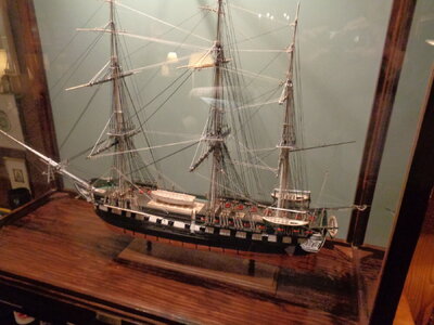

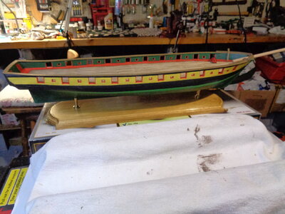

This is the first batch of cannons that I painted using your method, I think they look pretty good so far. I have not attached them yet. Rigging them comes next. This is my fifth model ship that I am working on. Here is a picture of my first.
