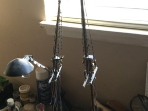

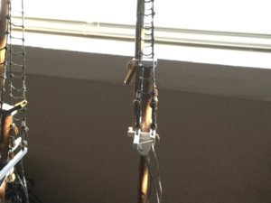

Folks: I am stuck on the upper foremast rigging. I have made the stanchions/rat lines on the port and starboard side of the upper foremast. My question is how are the lower deadeyes of the foremast crosstree secured? Do rigging lines run down to the deck deadeyes from the deadeyes on the crosstree or do they secure to the lower foremast? Billing Boats drawings (plans) are vague and internet photos of complete Bluenose builds do not show these details. Please see attached photos
thanks for you help

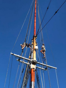

Here's a picture from the Bluenose II. It appears as though the upper shrouds don't actually have deadeyes, but rather thimbles or bullseyes. It appears that there are black futtock shrouds that run from the bottom of the cross trees (and presumably attached to the lower deadeyes/bullseyes) to the mast. Not sure if that helps or not, but maybe it does.
David

David Lester you have been a great help, the photo you posted is what I am looking for. The drawings that Billing Boats includes with the Blusenose kit has confounded me with inconsistencies on the standing rigging. I guess that you would say it’s open to interpretation for the rigging. I have found the different model manufacturers concentrate on different aspects of a model i.e.... hull and deck construction or heavily leaning on ships rigging.

Here's a bit more information that might be of some help. It seems that your Billing kit is of the original Bluenose, rather than the Bluenose II. I know the picture I sent is of the Bluenose II, but with respect to the upper shrouds, the two are the same. However, there are a number of differences between the two. Because there is so many references available online for the Bluenose II and not too many for the original, it takes some discipline to stick to the original and not be overly influenced by II.

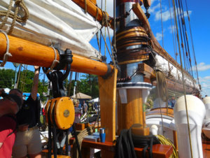

I just thought of another interesting detail about both Bluenoses. They both had/have internally stropped blocks, not rope stropped blocks. The Model Shipways plans point this out and it seems to be confirmed by every picture I've seen. The ones that come with kits are, of course, rope stropped. I've never seen a build log where anyone has worried about this detail. And what's more, while the blocks on the Bluenose II have a natural finish, I believe the ones on the original Bluenose are painted white.
I'm going to try to capture this detail and I think there are three options. One is to try to make the blocks or perhaps modify kit supplied blocks, by sanding out the groove and attaching an eyebolt or wire at the end, but that seems like an onerous task and would not likely end with beautiful results. The second option is to buy Syren internally stropped blocks. These ones are very beautiful and would work well, but they don't come in a small enough size to outfit the whole model with them, and they require quite a bit of work to assemble and shape. Then if I choose to paint them white, it seems a shame to just cover them up. (And they're expensive!) The third option, and the one I think is best in this case, is to buy Bluejacket cast metal internally stropped blocks. These have very nice detailing and come in a range of sizes to outfit the whole model. Giving a natural finish to these metal blocks can be a challenge, but if I paint them white, then they are probably the ideal option.
Here's a picture of the Bluenose II with naturally finished blocks and a couple of pictures of the original, which certainly appears to me to have white blocks.
David
