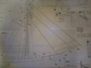

I tried to rotate but....?

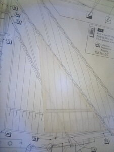

This view shows jib, fore stay sail and flying jib ....3 different sail sizes
This is drawing showing sails...
The fore stay sail and jib are exactly the same?????

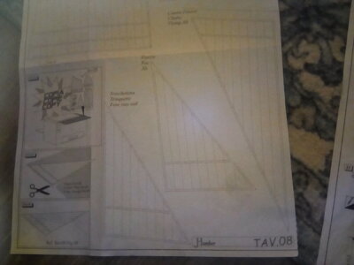

Instructions say make copy of sails to cut out.
My point is fore stay sail and jib are not the same size sail!
The above drawing is incorrect.

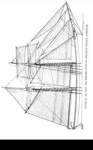

*rigging and sails could be altering according to H.Underhill book "Masting and rigging clipper ship" and converted into nice modern topsail schooner...
In such case model will looks more realistic and accurate in technical details...
Please consider all said above as just my private opinion about kit and nothing more than that...:)))
Ps
pictures - scans from the unarmed book , masts looks funny bended forward due to this
