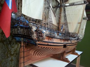

I want to show here one of the best Royal Caroline models I have ever seen, with red ensign
The modeler is the hungarian Králl Attila who built this amazing model in scale 1:24
WOW that is SOME model,thanks for sharing Uwe.
