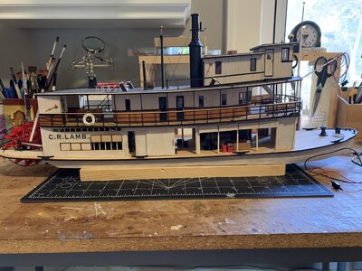

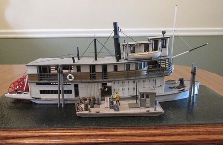

I will soon be finishing a waterline model of a stern wheeler - See photo - and I would like to create a stand that mimics the surface of a lake or river. Because I will be hiding the electrical LED wires that will exit from the bottom of the hull into a cavity in the base, I am not sure that an epoxy solution would work. But I have heard about various paint or Modge Podge or another shiny gloss medium as possibilities. But this is a first for me - all my previous models are just sitting on wooden bases or stands. Because of space limitations (the shelf where it will be displayed), it can't be more than 7.5-8" wide. (20 cm.)The boat itself is 5.5" wide (14 cm), so not a large surface. There is also a photo I found on Google (attached)IMG_6592.jpg that shows what someone else has done - maybe something like this, but no wharf or dock. And my preference would be to have still water. Any ideas??CR Lamb on stand.jpg

Great idea. If I did use plaster or another compound that solidifies a sit dries, I would have to create an opening in the plaster to accommodate the passage of the wires. Building a small dam around the opening for the wires?

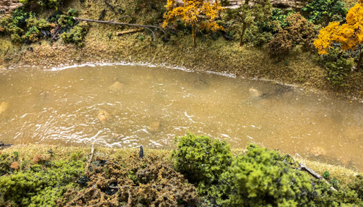

Here's a small section of my river that has an olive green tint due to painting the river bottom before pouring this product. The ripples are added by blowing through a straw just after pouring.
