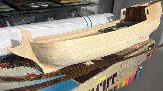

Since Im not an expert in planking, I decided to balsa fill the entire hull except the cargo hold
I think it will help me a lot when I start planking.
