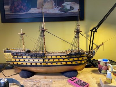

On my 1:90 scale HMS Victory model I had installed some standing rigging. See attached picture. As I started to install the backstays for top masts, I realized that they will be coming over the shroud lines potentially blocking me from convenient low masts ratlines installation. Should I install ratlines now or after I install back stays for top masts? Should I install some yards and running rigging that will be running behind the shrouds at the ship's center? I am on cross road. Looks like whichever way I go I will have big problems to proceed with installation. Please advise your preferable sequence of standing and running rigging installation.

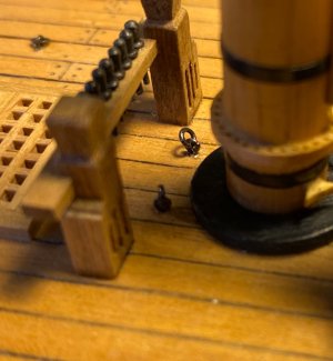

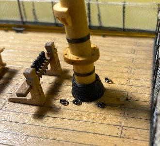

Now I will try to show you what kind of trouble I’m getting into. See this eyebolt? It had to be installed with a ring. All my eyebolts , about 18 of them, I installed without the ring. I was not able to accept this mistake. I was trying hard, but was not able to insert a new ring inside of these eyebolts on the model. Eyebolts were all getting crushed with pliers and tweezers. Eyebolts were in obstructed area. In the end I had to cut off all existing eyebolts and I installed new sets of eyebolts with the ring pre installed. This was lots of work, but I had to do it. This is why I’m asking these questions about the sequence of what has to be done first, and what must be done second.
