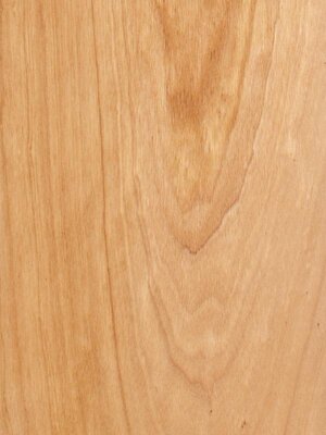

How about some good old Black Cherry? It’s a brown wood and some of the better heart woods have a nice, tight grain - here is an example of Glenn Barlow’s Pegasus that he finish planked in cherry..... you could also stain some Pear wood - it takes stain very well and would look awesome stained dark Walnut.

But Cherry is also a very good alternative and

Cherry is nice it gets a patina and turns a redish brown color.

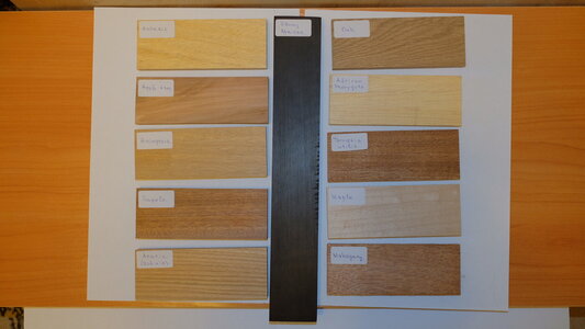

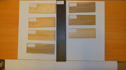

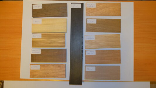

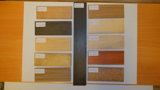

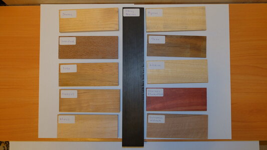

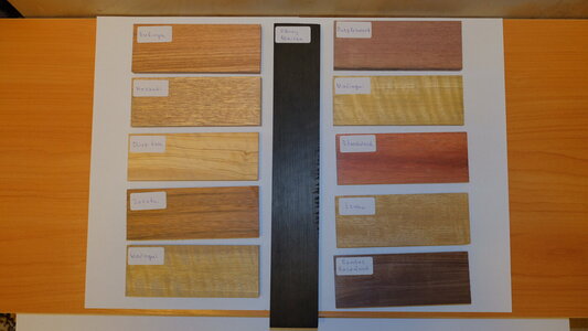

i think what you need is a sample set so you can actually see and touch the different woods. i have your address so hold on a few days and i will send you samples.

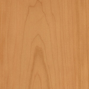

Anigre looks very close to common Cherry i have see both up close and personal and it is hard to tell them apart.

View attachment 220713View attachment 220729
Wow. Dave, that is really important to know. For deck work, I was avoiding cherry because it it too red to start and gets darker with time. The wood used on my last Corel ship was labelled tanganyika (who knows what it was). It was yellowish and light in color, and still had that fine grain with subtle darker grain within it. I like it a lot, and am looking to duplicate it.
