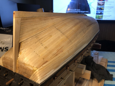

Showing halfway through final planking of the bottom. Do you see how the final planks are even in depth with the sternpost? Lower down, you can see how I dug out the first planking near the sternpost with a sharp, chisel edged razor knife and reinforces the soft balsa underneath with some yellow PVA glue in that area that is triangle shaped. No also that the planking of the deadwood is flush with the sides of the keel. All this shaping means extra knife work, but it's the only way at this stage to make the plans correct.
Once again Kurt comes through. Even if I have to make my own pattern of stern post, I believe I can make this happen. Love your cheaters in here. Very helpful.
