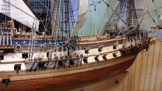

I have used maple as final planking on La Couronne for the white banded areas for the gun decks. It is flexible enough and has a fine enough grain. The darker areas will be slightly visible if you leave it in the white but less so if it is stained. Since is it is readily available, grab a piece from Home Depot and cut some strips from it to test it. For first planking, I prefer lime wood, which is softer than maple but takes bends well when wetted. If you are trying to simulate oak wood for the final planking, birch wood has the proper sized grain to simulate oak on a scale model. For final planking, mahogany and oak have too coarse grain to simulate the appearance of wood at model scale, although if the grain is not as important, they can be used. The red brown of mahogany and sapele is commonly used in kits for final planking, but there are checks and stripes in it that do not provide grain at scale.
Maple (white), walnut wales and mahogany hull bottom, all unstained and coated with clear satin finish. There is noticeable change in shades in the walnut planks and wales, and I didn't make any attempt to stain the lighter pieces to match.

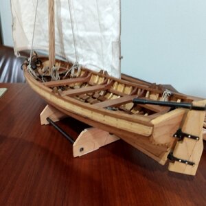

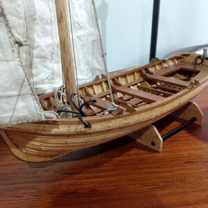

I used Maple for a replica of an 1800s dinghy and found it quite suitable for scratch building. I didn’t really have any difficulty with bending, forming, sanding or cutting. I intend on using it again if only I could get my hands on some. I can’t seem to find and Australian supplier.
