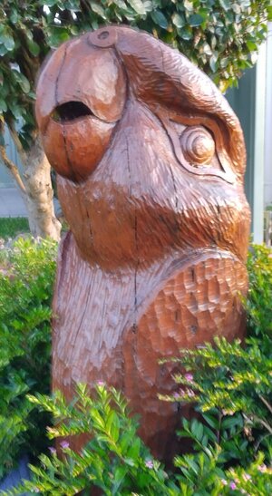

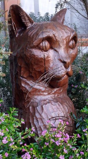

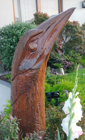

Thanks for the great advice and the wood history lesson, hugely appreciated. Some years ago I had a tree in my front yard which was becoming dangerous. I.e. occasional limbs dropping off onto the footpath. A boring beetle had attacked it and essentially ring barked every branch and limb under the bark. Had a tree lopper come round and had it removed. I told him I wanted to keep some as a memorial to the poor old thing. They also couldn’t tell me what type of tree it was but it definitely wasn’t a native Australia. I salvaged 3 pieces and carved my cat, a rainbow lorikeet (without the rainbow colouring) and an Australian Magpie (a stylised to match the shape of the offcuts) which now reside in my front yard. Guess I pays to give anything you’ve got a go even if it takes up a wee bit of storage space. They’re not boats but I suppose I could call them figure heads, and still fit in with the nautical theme of the post. Ha-ha.
