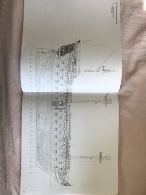

Per scaled drawings from my book the 100 gun ship Victory. Length is 227 feet. I just measured for you. A few inches could be an accumulated errors in drawing and my crude measurements.

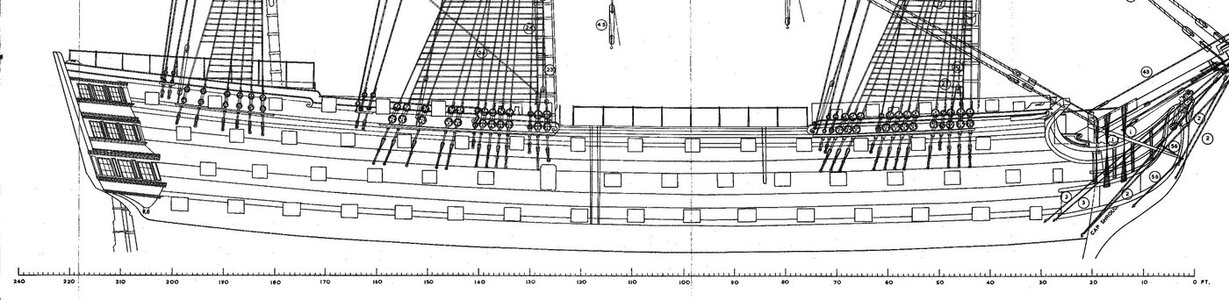

Thanks Y.T. I found this that answers my question pretty much. Looks like it goes from the stern railing to the figurehead on the beak.
