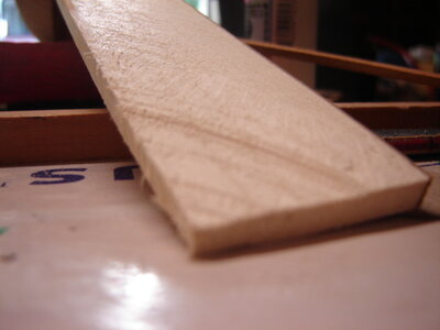

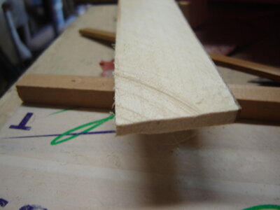

I have an old crumby tablesaw. It works reasonably well but it does this on every cut I make. I hold the board tight against the fence so I don't think I'm wobbling as the blade enters the wood. I'm wondering if the bushings/shaft are worn and it takes a second for the blade to settle down. The blade has about .010" of run out and maybe another .010" of slop. Any ideas?

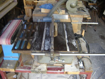

Maybe a photo of the saw would be of help.

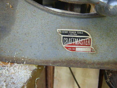

You guys ask hard questions. It's old, I didn't know there was a nameplate on it until I went and looked. The fence is kind of iffy. I put new bushings in it when I got it 10 years ago but I think the shaft is kinda worn. It's a belt drive and the whole arbor kind of hangs off one bolt. I'm going to do a Google search on it now that I know it's name. I have a separate DIY saw for cutting planks. It works a treat.

if the saw cuts all along the board the way you show, it is a blade problem. the teeth on the blade are wacked out of alignment. Some woodworkers bend a few teeth to get that rustic saw cut look.
if it happens only when you start a cut it is the saw. But to make sure try cutting again with something thicker like a 3 x 3 to make sure there is no wiggle in holding the board against the fence and on the table.

operator error if the width of the board is wider than the height of the fence when you first feed the board into the saw the board pivots at the top of the fence ever so slightly and kicks out at the table level. It is so slight you don't even feel it move.
