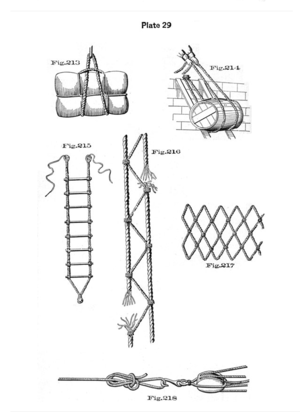

Jacob´s ladder is shown on figure #215 on page 61

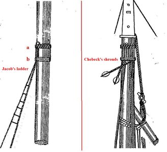

Hi Jeffrey.
I haven't met any Jacob's ladder separated from ship's shrouds but answering your query, here is my suggestion.
The ladder could be attached on a pole mast, the same way as the shrouds of a chebeck were being set.
At the below sketch (left )the ladder comes up and its both rope ends are being secured by two rope loops (a-b).
