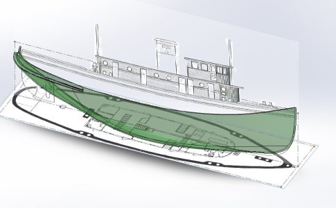

The other day someone asked me if I could work up a tugboat for him and he suggested the John G. Alden tug Luna. I have done a few, smaller, tugboats in the past, in 1/8 and 1/12 scale, but I thought this might be great fun as the ship itself is a just short of a hundred feet, which give a model size of 48 3/4", which is a nice size.

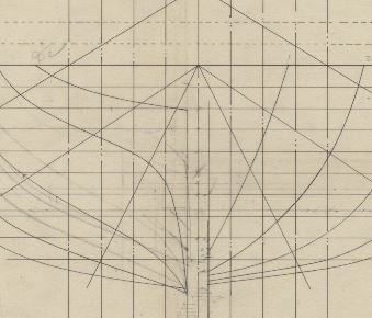

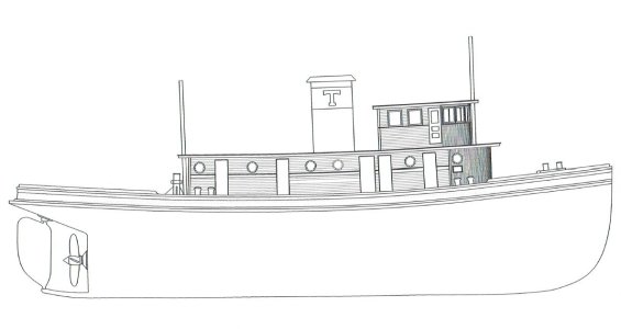

I found a set of lines at the "usual place', the museum at MIT and bought them. Combined with the drawings from the Luna Preservation Society, I was able to come up with an excellent 3D shape for the model.
As I have described recently, I design my models in SolidWorks but do use a dedicated product for making hull shapes. Considering this is not a complex hull shape like, say, a J-class sailboat, I am pretty sure I could have done an adequate job directly in SolidWorks, using the various surface features, but it's faster in Rhino, and the end-result was quite acceptable.

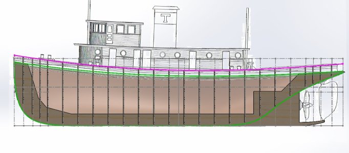

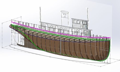

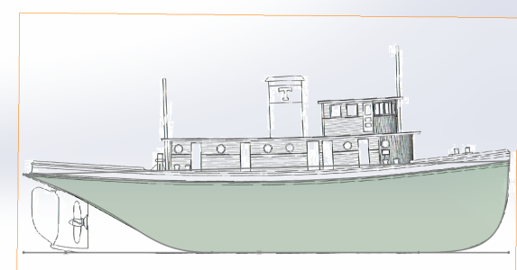

The first picture shows the line drawing from the MIT museum. They are available at a very reasonable cost. Of course, since there is a copyright on the drawing, I have reproduced a tiny portion here. Next there is a line drawing from the Luna Preservation Society website. There are a few drawings on the site but there is not enough information in them to actually create a 3D model. One really needs the drawing from MIT to figure out the shape. Next, there are pictures of the 3D model,, inserted into the design program.
Note that the side-view is a preliminary shape, and it was improved later. The isometric view has the corrected shape. I guess they should have been in the reverse order for this post.

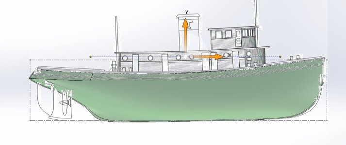

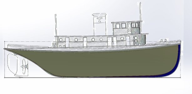

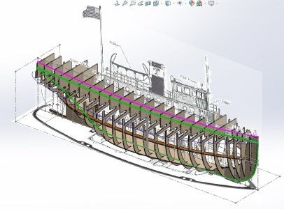

Well, it turns out I am not satisfied with this shape. I just don't seem to have enough space for that typical, massive, prop. I have decided to use a different approach and use the surfacing features of SolidWorks. It is way more tedious to do it this way, but I will have more control in the end. Here is a preliminary attempt. 1776728803234.png

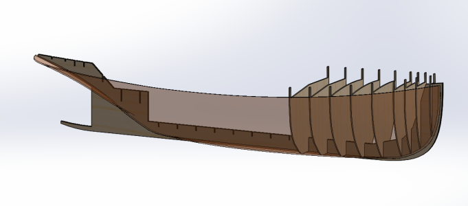

Oh, boy, the excitement is building. In the previous post, I showed the outline of the "fake keel". From that point, I added a "fake rabbet" where I want the hull to end and now I have a proper 3D shape to work from. Please note that, in this particular model, there will be no actual rabbet part. In other models I have added either an external rabbet or an internal garboard plank, to help with the actual planking, but this builder is a seasoned modeller and will not need the extra help.
Note also that I will have to figure out the extensions to the frames, in order to build up the bulwarks. The drawing I had from Alden only showed the bottom of the hull, so I will have to work on that using pictures of Luna.

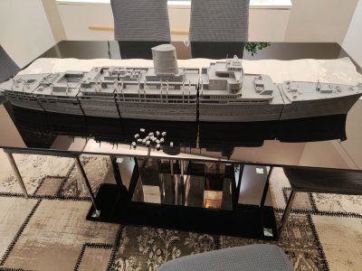

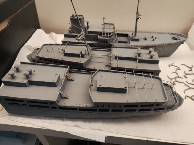

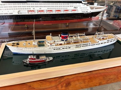

This is great work and prompts me to ask you, or perhaps the group on the thread, a question. I was buying 3D-printed "kits" of ocean liners from Ocean Liners of the World at 1/200 scale. They built for me the SS Ariadne of Eastern Steamship Lines (the first ship I ever went on) and P&O's Arcadia. In both cases, they printed out the hull and superstructure in four or five pieces, and then the lifeboats, davits, masts, and funnel separately. I assembled the pieces, painted the model and installed lights, decks, etc. Attached are pictures of the Ariadne, when I got her and after completion, and a picture taken of the Arcadia prior to shipping the parts to me.
They do great work, but have now decided not to continue printing models at this scale, owing to the difficulty in doing so and complications with international shipping/tariffs. Does anyone know someone who prints at this scale? I have a long list of models I want produced. Thank you.

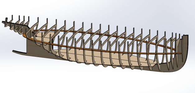

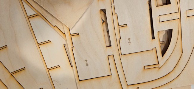

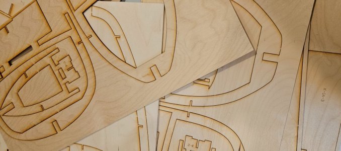

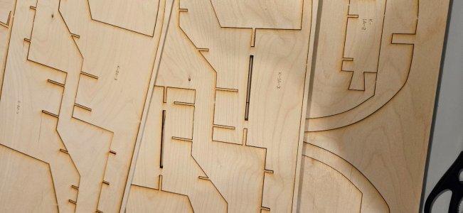

It's always fun when the frames start to take shape. I am hoping to have the complete frame set ready to go to the laser-cutter at the end of the week. We'll see how good my time estimates are!

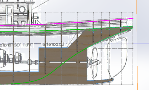

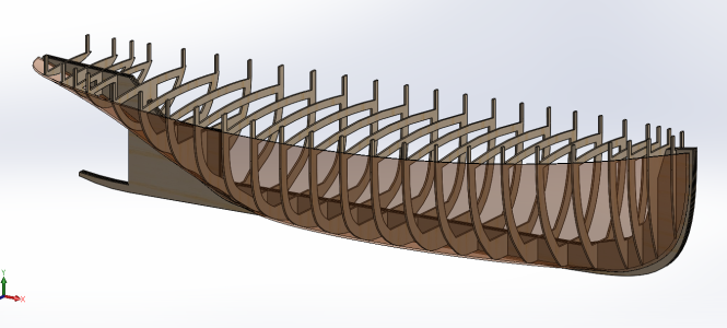

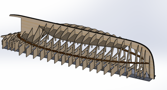

Details, details. I've added a guide for the engine shaft on the two inner keel sections but I decided to leave rudder shaft position to the builder. In this scale, there is little space left under the counter at the stern and a builder might want to put the rudder a little further forward, where there is a bit more space for servo arms.
We have a boat! We have the floorboards, a little surface for the rudder servo.

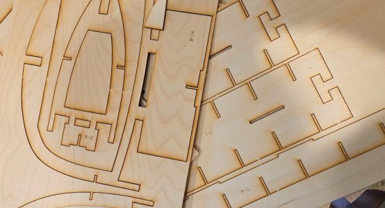

Next, we need to add the T-rail (as with all my frame sets), create the nomenclature for the parts, create the laser-cutting diagram, and cut the parts!
