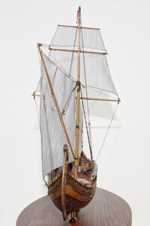

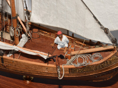

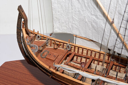

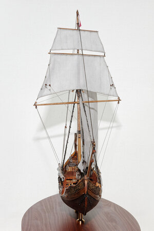

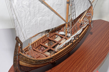

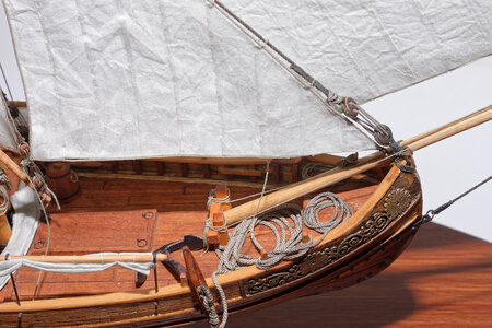

Kancabaş, a Marmara Sea boat (1:48, in fact 1:36)
Feb 27, 2021
345
323
Moscow, Russia

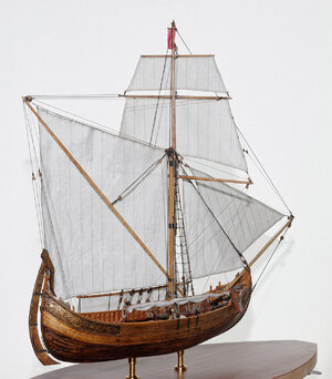

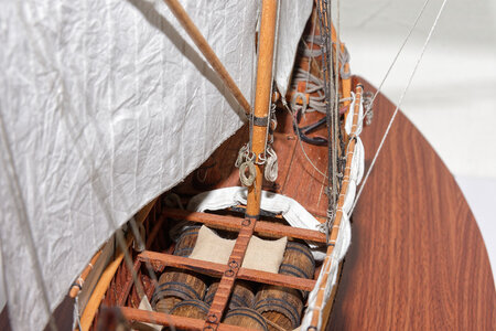

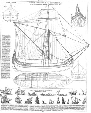

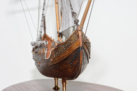

Another completed model, this time it's a Chinese kit by Shicheng. I suppose that the kit copies the Turkish model by Fatih Karalar (which was in the 1:36 scale). In turn, Mr. Karalar's model is based on a 19th century engraving from the “Souvenirs de Marine” book. As additional sources I used various paintings and watercolours by Amedeo Preziosi and the K-H Marquardt's book “Bemastung und Takelung von Schiffen des 18. Jahrhunderts “.

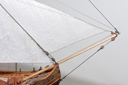

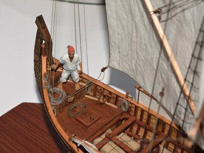

I made the following changes in the kit:

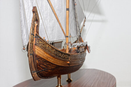

1) Added two bulkheads afore and abaft the open part of the hull, since they are in the historical design;
2) Added waterways and drain-holes;

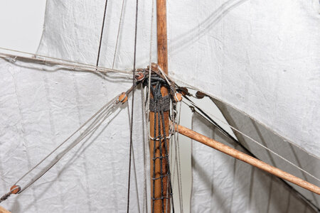

3) Modified the rigging;
4) Added some goods in the hold;

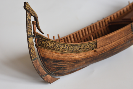

5) The ornaments are laser-cut from veneer. I designed them myself, using as reference the pictures of Sultan kayaks I took in the Istanbul Maritime museum.

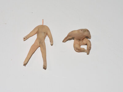

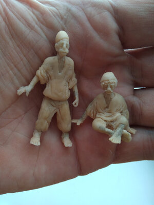

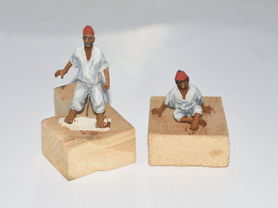

The sailors' figures are made from polymer clay and it's my first attempt to create something like this.original_print.jpgDSC_5532.jpgDSC_5533.jpgDSC_5535.jpgDSC_5540.jpgDSC_5542.jpgDSC_5543.jpgDSC_5544.jpgDSC_5545.jpgDSC_5547.jpgDSC_5550.jpgDSC_5552.jpgDSC_5553.jpgDSC_5687.jpgDSC_5690.jpgDSC_5690.jpgDSC_5691.jpgIMG_20190831_134131_01.jpg
A very nice model, looks exceptionally well built. I have never seen a comparable ship here. My search was also immediately successful. There is a "de luxe" version with etching material etc. I am always very hesitant when it comes to shipping from China. Are there any problems?

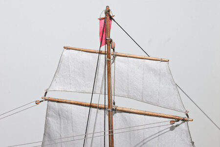

Thanks a lot! As I know, the quality of Chinese kits is often unpredictable. But with this one I had not any specific problem, though I replaced many details like the mast, the bulwark rail, the bitts etc. And be ready to adapt some unprecise elements. The photoetched details were good. Maybe the assembling manual was not so clear.

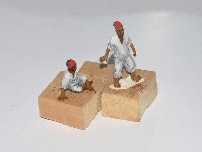

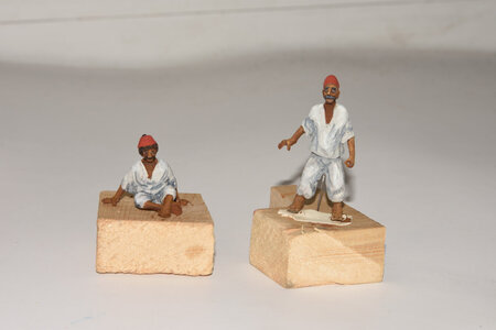

Thank you for the information. A really interesting model, I can't get it out of my head. If I may ask - why did you replace the masts? Are the figures well made, carved or molded by you?
I replaced only the lower mast, because it was too thin for me. On the other hand, the bulwark rail was too thick and rigid,and impossible to use.

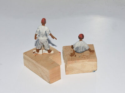

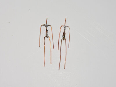

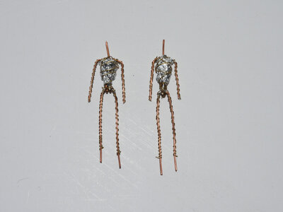

And that's how I made the figures.
Thanks, I understand that only too well. It is often the case when you look at the construction kit specifications. Sometimes you wonder if nobody really thought about it. I am currently building the Ocre Cazador. A good model, but also with flaws. About the figures - it's amazing what you've made of simple materials. Respect.

Well, I'll try to, though my English is too poor for such a complex subject :)
This tint method is not my idea, the first to use it was Dmitry Shevelev, as I know.
Here is Wikipedia about the bitumen varnish: https://ru.wikipedia.org/wiki/Битумный_лак (unfortunately, it's only in Russian). Shortly, it's bitumen with some hydrocarbonic solvents. Here in Russia it's almost everywhere in the market.
I dilute it quite highly with white spirit (mineral spirit), otherwise the surface would be dark, but glossy and sticky. It's better to try various proportions before applying on the model.
I also use it to colour the ropes for rigging (in this model too) and as washing, like in plastic models.
The sailors' figures are made from polymer clay and it's my first attempt to create something like this.View attachment 224851View attachment 224852View attachment 224853View attachment 224854View attachment 224855View attachment 224856View attachment 224857View attachment 224858View attachment 224859View attachment 224860View attachment 224861View attachment 224862View attachment 224863View attachment 224864View attachment 224865View attachment 224865View attachment 224866View attachment 224867
