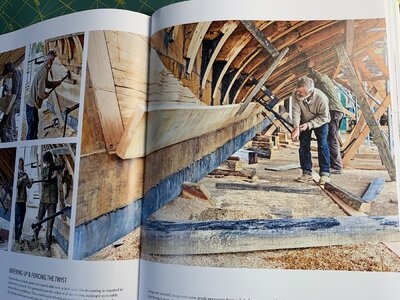

Despite my own kit having been not delivered yet, I have been seriously studying Heinrich's build log ( his being the earliest ) as well as browsing thru many of the others. I have noted a whole bit of discussion involving that part 18 very long compound taper bevel below the bearding line and just today I found a great prototype ship photo that beautifully displays that exact bevel.
I post two pics here, 1, the cover of the book and 2, the photo showing the bevel. Note the lighter colored area in the upper part of the deadwood and extending across the two pages of the book.

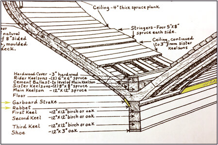

A nice picture, Alf. Thanks for sharing. Visual what was discussed and showed in this drawing fro The Saga:
Highlighted: The garboard strake in the rabbet.
Ya, that _is_ a very good drawing, I like technical illustration. What is this book "The Saga . . . ", I noticed it mentioned more than a couple times now? That might be a nice acquisition for my tech library.
