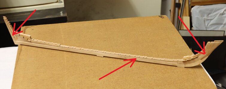

The Keel and the Stem and Post were made from solid wood, did they actually plank them? I am going to use Wood Veneer to cover the keel and post and not plank? will I be correct?
Hello, excuse me, if it is permissible which details are you talking about? Thank you
My mistake. The stem and post are planked! It makes sense since the planks can be replaced to maintain the ship.
I liked your first answer better Kurt. In real life these were pieces of solid lumber, weren't they? Many kits cover them with strakes but I don't think this is the way to go. To simulate the solid lumber we either need to use solid lumber (scratch) or cover the kit supplied plywood with veneer.
Or maybe I'm missing what was being asked???
No I think you are right that is what i did ask it would seem to me that a solid wood was used??
I have to make the stem, keel and stern post. I think I'll use walnut, not that it matters, since the bottom of the ship will be covered in off-white paint to simulate the "white stuff" used to discourage marine worms from eating the hull.
