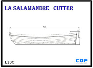

It is the Cutter in scale 1:48, full rib construction with a total length of 130mm

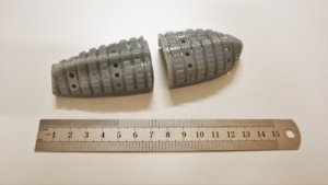

Before I want to show you the "old" version which was built inside a jig, similar to the Salamandre, here you had the "problem, that you had to put the framework out of the jig before you could make the planking. Carvel-planked

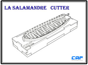

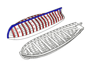

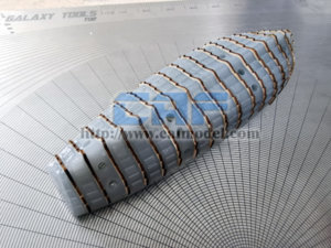

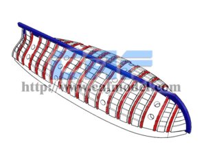

With the new version of the Cutter-kit you have a negative form on which you can install the keel, frames and also the outer planking, all based on a rigged form.
Clinker built Cutter

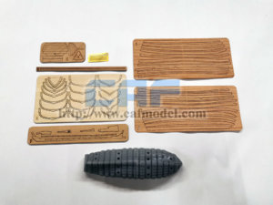

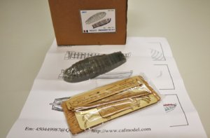

But now let us have a look on the parts of the revised Cutter-kit
The complete content:

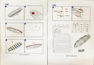

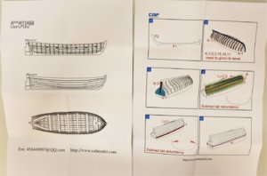

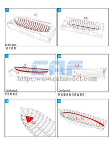

The small manual describing the different working steps - in my opinion enough information

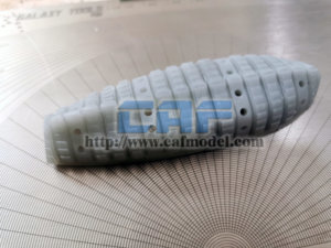

The negative basis - simple but great idea - you can see the steps for the planking - it is a clinker built cutter !!!

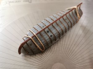

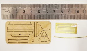

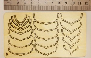

The frames / ribs - prepared for clinker planking

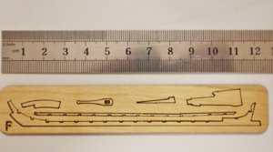

the keel and keelson, rudder etc.

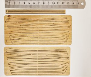

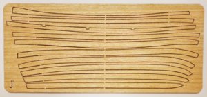

The pre-cut planking
One side of the planking in more detail - I guess there is now problem with the grain, it is fine / small enough

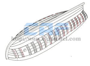

In the following some more photos from CAF showing some of the working steps
