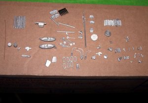

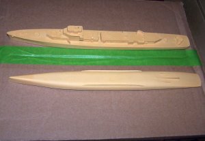

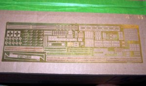

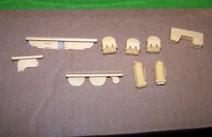

My in box review of the Blue Water Navy 1/350th scale U.S.S. Gearing. After some investigation I discovered that this kit has been around in one form or another for well over 20 years. About 10 years ago the then current owner of the company created new molds of the hull and superstructure and cleaned up much of the white metal parts. Also at that time a new fret od PE parts was made. After opening the box I discovered that the contents were well protected with bubble wrap and soft paper towels. All loose parts were in bags that were stapled shut, A quick count indicated that all parts were present. I may end up buying aftermarket brass gun barrels for the twin 5" mounts. Also there were no decals or dry transfers for the ship's number or name. So I will be searching the internet for appropriate numbers and letters.

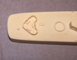

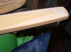

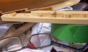

What will end up being the most time consuming portion of the build is the removal of the excess resin from the underside of the upper hull. If I decide to finish the model as a waterline display there is no need to clean up the top of the lower hull. That will also eliminate some of the more challenging sub assemblies, the prop shafts and propellers and the rudders as well as the sonar dome. Clean up of the remaining resin parts looks to be straight forward with no challenges. The sheilding around the starboard midships machine guns is so thin that it split and a small piece is missing. It should be easy to repair. Ships railings have always been my achillies heal on projects like this but I noticed during a glimpse at a build log of a Gearing that the builder added the railings early in the project instead of last like I have tried in the past. The PE seems to be a bit more robust than what I have used before and I hope that helps in attaching the PE.

I just started removing the excess resin from the underside of the upper hull using a dremel tool to get the bulk of the excess. It sure generates a lot of dust and progress is very slow making it tedious work. At this point I sure wish I owned a belt sander. If anyone has a suggestion feel free to do so. Once I get the project really under way I will open a build log.
