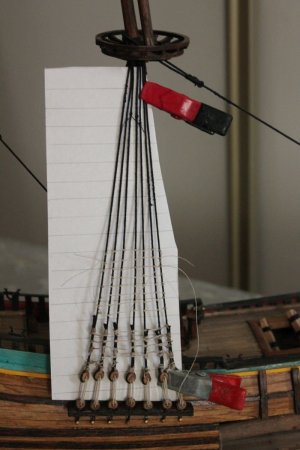

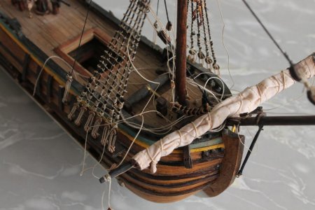

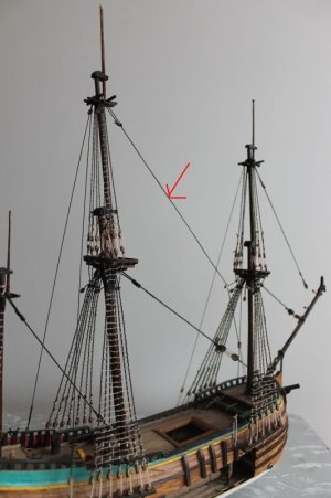

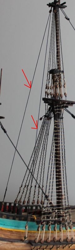

For the upcoming model builders' day, I need to pay a little more attention to the flute.

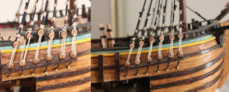

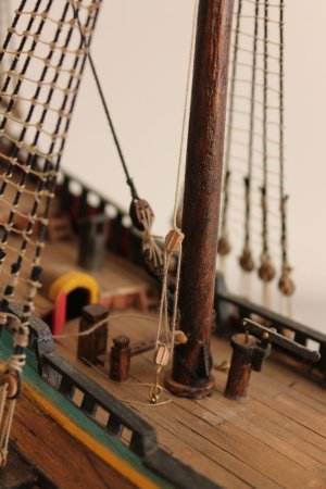

One issue I've been struggling with for some time is the uneven spacing of the deadeyes on the fore shrouds.
I tackled that first. It turned out that I could lower the deadeyes a little without too much trouble, so without too much demolition.
It looks much better now.
The next step is to apply webbing lines and extend the masts with a steng.
But that will come a little later.
Left: Old situation, Right: Current situation.

Good morning. That is a massive improvement. Excellent. Cheers Grant

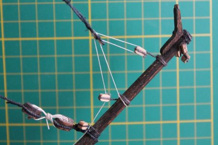

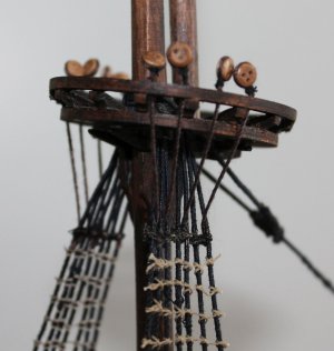

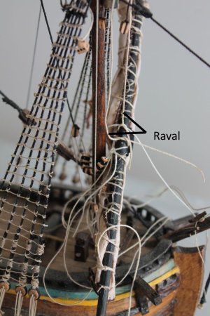

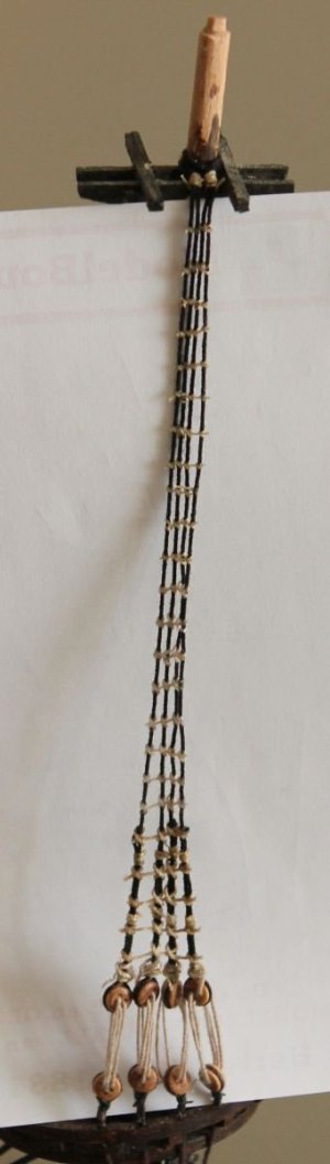

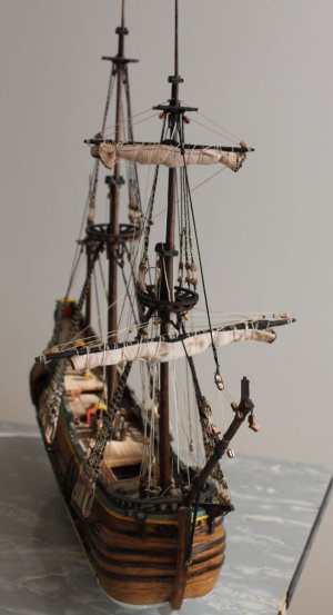

I started with knotting the ratlines.
And after a while I finished this knotting. One sailor has to test it immediately.

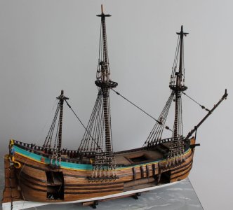

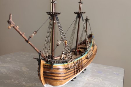

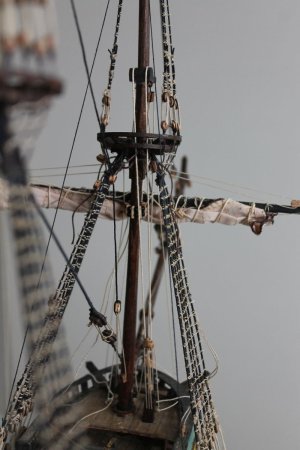

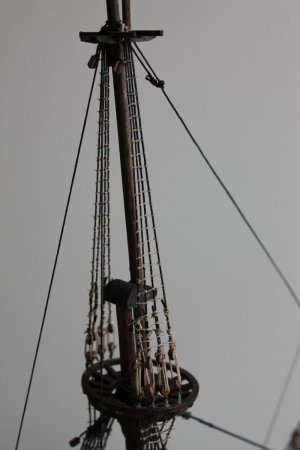

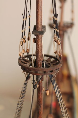

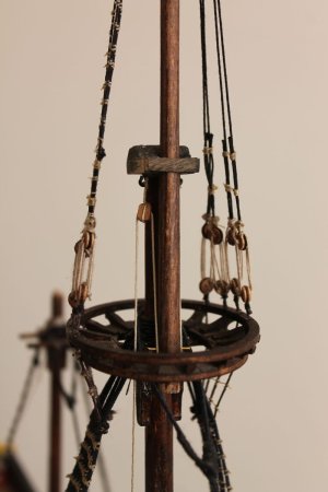

After finishing the ratlines, the “putting” have now also been placed. They still need a few more ratlines.

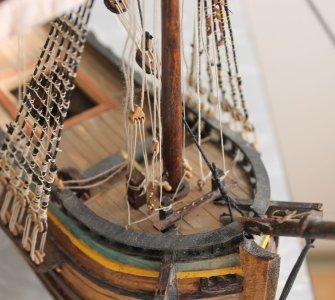

This is from the foremast:

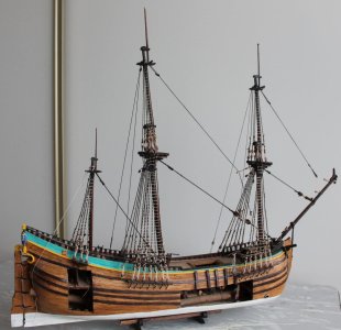

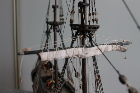

And from the mainmast

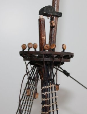

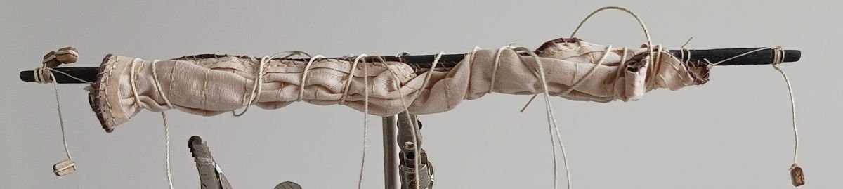

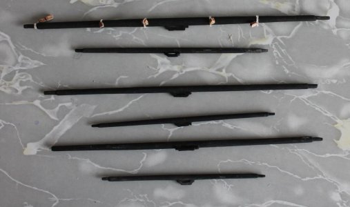

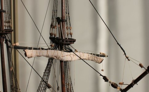

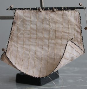

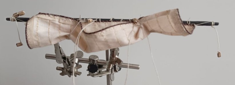

I have also shaped and blackened the yards and I am now busy knotting the various blocks to them.
to be continued
