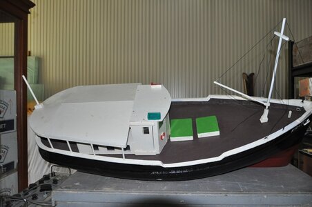

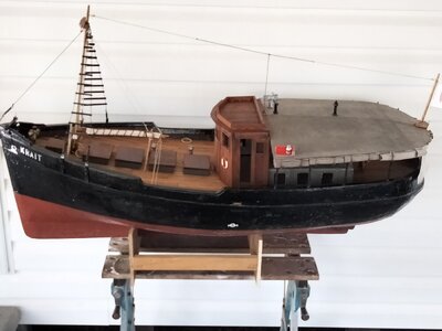

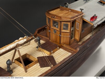

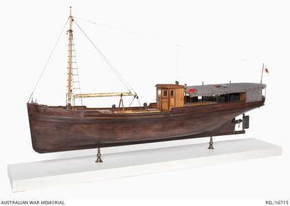

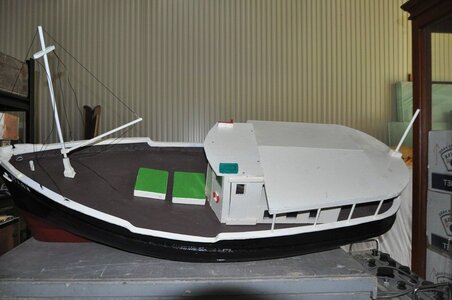

At our Historical Village and Museum here in Hervey Bay, Queensland, Australia,we have been given a model of the "Krait", approx 4 foot long.
We intend to use this model in a display related to operation "Jaywick" as we are just across the water from Fraser Island where Z Force did their training.
This model lacks authenticity which I have been asked to provide and apply.
The last model I made was a balsa plane around 75 years ago but I am handy with wood, metal and rope, also woodturning.
The pics attached are of our model plus the one in the Australian War memorial.
I can't expect to achieve the AWM model standard as I only have 1 1/2 months to complete this.

When you compare the picture of the model in your opening comment, to the Modellers shipyard kit you can clearly see the hull is the wrong shape.
Maybe you can email the vender of that kit and get a copy of instructions and ships plans for use in upgrading your kit.
If you click the link for the MV Krait above it opens to web page to buy the kit but more important it has a link to download the instructions.
They is a lot you don't need, but the back shows mast, yard and rigging information.

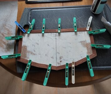

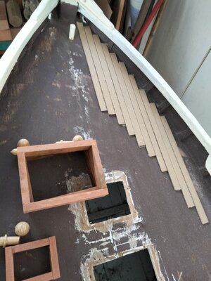

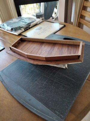

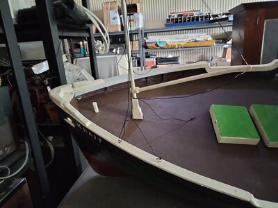

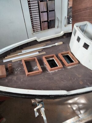

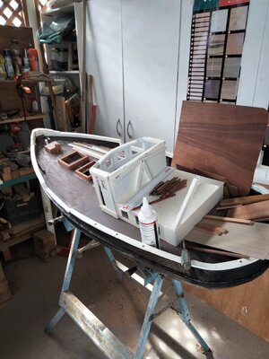

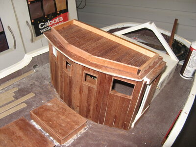

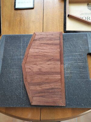

Progress so far
Stripped original model down and started to make parts such as extra hatch covers etc.. and cutting some cardboard planks
BT

Progress on wheelhouse, nearly finished.
Can anyone help with the correct gaff boom setup on the Krait?
The ANWM model shows the halrad going to the end of the boom while the Modellers Central Krait instructions show it next to the mast.

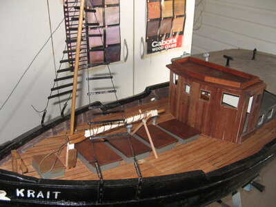

Before and after. Now completed. Thanks for all the help.
Brian
