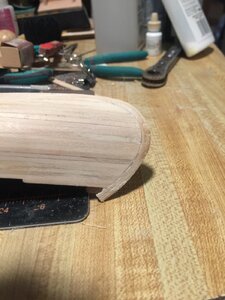

After letting planks dry good for a day ( got tied up on other projects) I removed the clamps to check progress.
I small fix need on last two strips on one end where they didn’t lay flat on stem to fix but should be easy.
At least I am now seeing a shape that resembles a canoe!
Just need a little more time to put more planks but my wife and I are stay with my 96 year old mom while her care taker is on vacation so project is at house across town for a week.
Here is last update on work
Looks great! I had particular problems in the "twisted" planks approaching and then contacting the stems. Some ended up still not twisted enough or parallel with the stem nose. . . maybe my clamping was not well placed there. I am now looking forward to second build, probably only 17" that time after finishing the present 19" which still has about a 3/4" wide midships bottom to be closed off. I am moving rather slowly tapering the ends of the strips on each end and fighting the vertical alignment with my bad and now loose No. 5 station which is spinning on the pins set for the first plank like a cat entry door from the outside. Keep up your nice work. I cannot continue Thursday as I am a Range Safety Officer at the local gun club for a public shooting day (hunting sight-in mainly right now.) I will have to buy out the local store's stock of sandpaper on the way home. PT-2

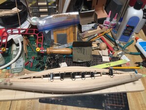

Back at the canoe again after a week of traveling for my other hobbies of Model Railroading in Nebraska.
I got a few more planks laid on the canoe hull and now I am starting the bottom closing process!
Slow speed ahead the Captain said!
Slow speed, Aye, Aye Captain and steady on the helm. Closing is an interesting process with the herringbone as long as you are not fish intolerant. I am waiting for a new order of mahogany being curious what grain and color that will be for a second canoe. Strips look nice. PT-2

Slow is good as long as you keep at it.
Closing the hull can be faster, as to more strips can be laid in one session: don't have to wait so long for between each strip being laid. Dry fit every strip once or twice to make sure the angle of the cut is good in order to avoid wide gaps in those areas.
The canoe looks great. The pear wood is a pleasure to work with...

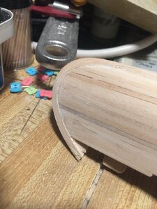

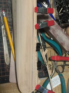

Finished the bottom in and separated from base board.
Started adding extra rows of strips to ends to bring stem up as directed
Working now on making piles of sawdust as I start to smooth the outsides of hull.
Have one stem almost shaped and with a bit most cleanup will be ready to add stem boards or what ever they are called!
Now to read up in the guide more for process to next steps!

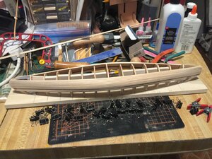

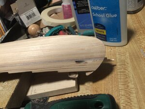

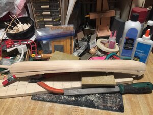

After much time taken here and there to sand the hull I have what I think will do!
I have glued on end stem ribs and cut and sanded to shape today!
I have also glued one of external wale ribs on!
I am not truly happy with canoe over all, it was a test build with cheaper basswood bought locally. Much poorer wood and I got in a hurry and some strips didn’t stay with station alignment so bottom looks horrible.
Sanding and putty helped as I will paint this hull and give as gift to a friend
View attachment 181783View attachment 181784
If you can go past the putty and remember how Gilles said that "minor" defects/gaps can be filled by applying some glue, smearing it about with your finger and orbitally sand over the area. The sanding dust will mix with the glue and fill the gap. "Minor" gaps are subjective but with my dark Mahogany I notice that the lighter colored Tightbond may still show up. In a light tone wood it is invisible. "Trust Me" the car sales man and manager said. . . Oh yeah? IT worked in my first light tone canoe but does not in the dark Mahogany. You can always go to the painted hull like Gilles did in his last classic and traditional dark green which looks great! Keep the focus and you'll get her ready to float. PT-2

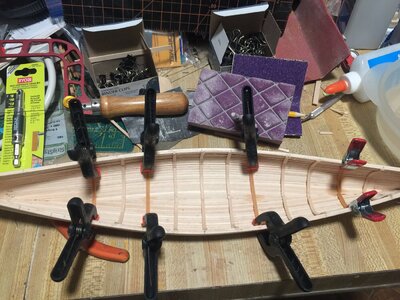

I got second external gun wale attached and after hours of drying I got the extra planks trimmed down to gun wale.
Now to start on inside!
Jul 2, 2020
4,108
588
Eugene, Oregon
Every step or stroke of the paddle takes you further along and it looks more and more like it wants to float. I will be looking for more of your excellent work. PT-2

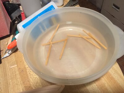

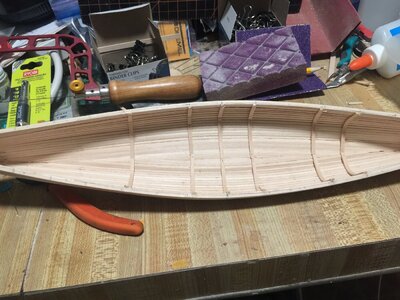

Sanding done for inside.
I started working ribs in batch based on clips I have
Next batch of ribs soaking
And second batch (darker color as they are wet) glued in and drying.
I did the ribs in my canoe in the same manner matching the keel end of the opposite side to the previously one set and midships fore and aft in a balanced manner as you are doing. It was best for my bad eye but I still did not get all of the mahogany ones well placed. Never again mahogany . . too stiff and brittle even with soaking and my added shaping with the electric bender. Actually I liked the ribs except for the care needed in trimming the end ends to the gunnels. Nice progress by you. Are you using the CA or Titebond. I used CA and glued my fingers together several times hold ine rib in place for a few minutes. I then added either binder clips or clothes pins depending upon the spacing available. I'll be watching your nice work progress.
