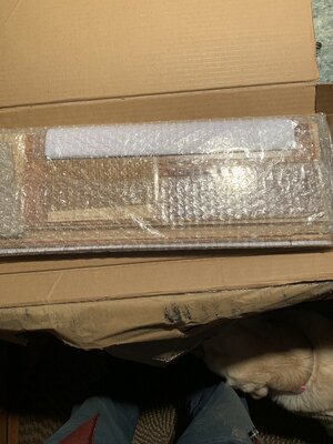

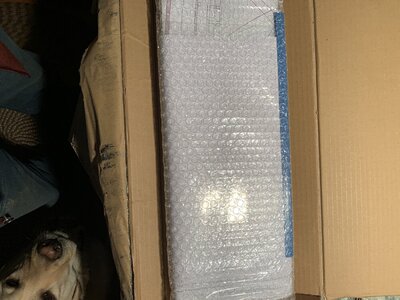

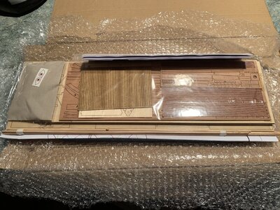

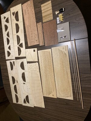

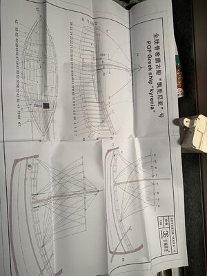

The kit finally arrived in a plain corregated cardboard box with instruction manual in Chinese, single plan sheet, and laser cut parts except for small dowels. I will likely swap out and upgrade some of the rigging fittings and lines. Kyrenia Kit Box.jpgKyrenai Wrapped Parts.jpgKyrenia Laser cut parts.jpgKyrenai Kit Instruction Manual.jpgKarenia Instructions Process Example.jpgKyrenai Parts.jpgKyrenia Unfolded Plan Sheet.jpg
While my Bluenose MS2130 is being finished I have time to study this kit carefully to better understand the insturctions via grap;hics as all text is in Chinese. I will bring some of my side research into the wreck discovery, recovery, and reconstruction to bear on how this model will be worked out and possibly tricked up according to the best underwater archaeological research papers on the Kyrenia and the three following reconstructions that have been build and sailed. Ships and boats didn't move very fast in the Late Bronze Age so I don't have to stress over a fast beaten tempo of rowing while there is no wind to fill the sail.
Rich (PT-2)

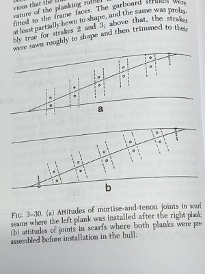

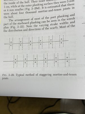

Now a diagram showing the close but offset mortise and tenon layout which secured the strakes into the hull which was structurally secure in itself. I will simulate the anchoring pins:

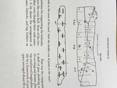

Next is a diagram of securing stakes at the scarf joints which the kit does not recognize or include:
And a drawing of some of the recovered scarf joints with the strake fragments Kyrenia Wreck Scarf Joints Fragments.jpg

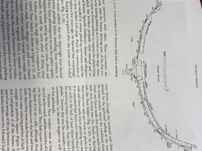

Lastly for now is a cross section of a frame and longitudinal members from the wreck remains"
And a drawing of some of the recovered scarf joints with the strake fragments View attachment 258817

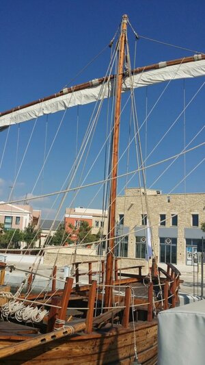

@PT-2 Yes I agree with that. Still the pottery remains the only source, considering that ship wrecks remains of that period are only parts of the lower hulls.
That said, I recall when I finished the drawings of the model in the above video I have discussed the case with one of the Kyrenia replica builders at the University of Cyprus (I am in Cyprus) and the verdict was that such a version of the ship may have existed and may not have existed.
So Rich wish you fan with the model and I let you know that I have a lot of photographic material of the replica of Kyrenia (the ship is in the marina hundred meters away from my house) which is in your disposal if you wish it.

There were 2 replicas. Kyrenia II is the picture I posted above.
Definitly pegs and tenons. Shell-first method was used by this Ολκάς (Olkas) the commercial ship of tha era.
